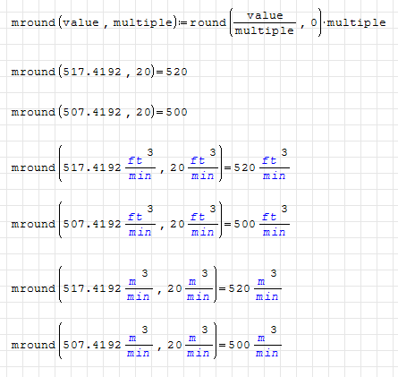

I would like to have the answer "round" to the nearest XXX. In this example, I would like an answer that gives 520 and another that gives 500
I do not want to truncate to get the 500 as I may get 589 and would like to round up
Apparently, units are part of the problem
#2 Posted: 4/28/2016 3:38:05 PM
1417 likes in 2873 posts.
Something like this?
ElSid 4/28/2016 3:48:00 PM, frapuano 4/28/2016 5:24:00 PM

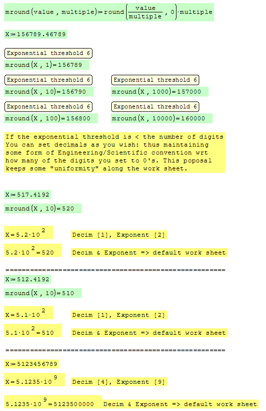

#8 Posted: 4/29/2016 10:41:13 AM
983 likes in 6866 posts.
