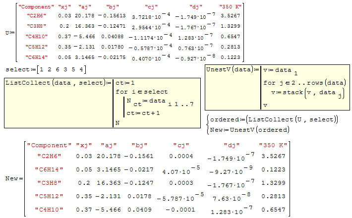

Does it make sense to have the system ordered 'x ascending' ?

Hi Jean,
I was not aware of putting things sorted by x ascending, but it looks good.
