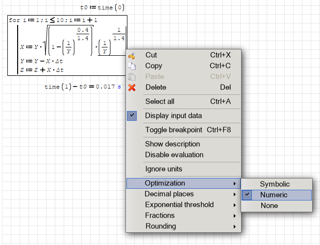

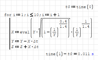

I do apologize as I should have checked previous posts. I see the optimization solution in a recent post. This is definitely solving the point. Please don't fight to each other, maybe even in a non-related answer there is something to learn. Thanks to everyone for your time.

WroteI do apologize as I should have checked previous posts. I see the optimization solution in a recent post. This is definitely solving the point. Please don't fight to each other, maybe even in a non-related answer there is something to learn. Thanks to everyone for your time.
