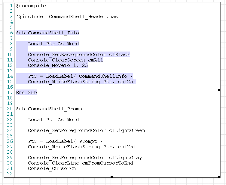

Memo control based on Regions.Control and FastColorerTextBoxCF. Used as an example of the region without a place holder.
