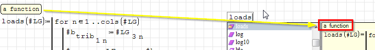

P.S. the dynamic assistance show you that loads is a function; however you can set a description text to point out this fact.

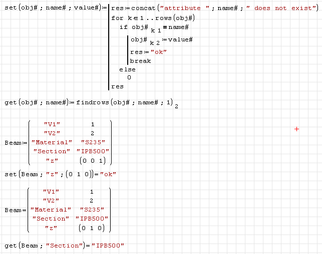

Both structures can be just global variables or single complex objects. You can fake objects with named attributes by using a 2-column matrix with name strings in the first column and whatever object in the second column and define a corresponding set(structure,name,value) and get(structure,name) function pair.
Functions can provide return values and can modify arguments, if these are given as names (call by reference). They cannot modify global variables (any assignment to a name which does not occure in the formal parameters list creates a local variable, shadowing global objects of the same name).

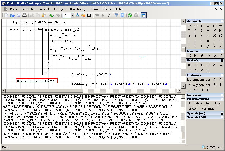

The problem is in the mismatch between data structure and indexing. You have a vector of row matrices and try to access the elements just as in a matrix. You have to use nested index levels.
The output window displays the output of trace(), a function for debugging, explained in the wiki

Thanks for the response and explination. I seem to have an error when trying to replicate. "Argument doesn't match to expected kind"
Error in Accessing System

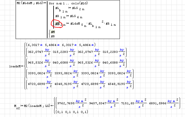

There is one interesting error however which is that it returns one of the matrices as undefined (see attached).
Thanks!
Creating functions Beam - Uniform - Multiple Beam.sm (72.2 KiB) downloaded 1466 time(s).
#18 Posted: 5/15/2014 12:36:23 PM
Thanks!
You are victim of bug SS-40. Andrey has marked it as fixed but did not yet roll out the fixed version.
You can identify such problems by setting the cursor on some name and watching if all occurences of that name are highlighted in the expression. If not, then there might be a typo or a hidden empty text index.
See the marked spot in the attachment and compare this to your original file.
