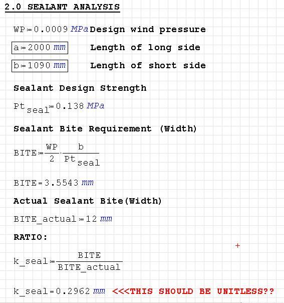

#1 Posted: 8/11/2012 1:04:58 PM
Maxx
Maxx
1 likes in 8 posts.
when similar units are divided the result does not cancel the unit
please help and see attached file.
thanks and more power to SMATH!

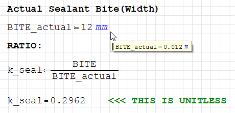

Hi megamaxx,
you have forgot the unit in the BITE_actual definition (see the attachment)

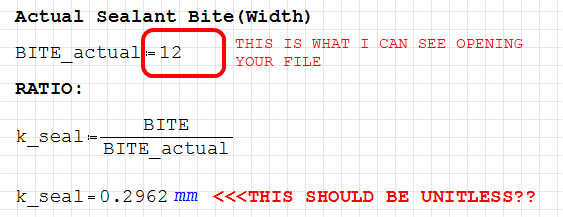

#6 Posted: 8/11/2012 1:41:10 PM
I tried your example and got the unitless value, as it should be.
Could you attach your *.sm file, please.

from wath I can see from your *.sm file, you simply forgot the unit in BITE_actual (see the attachments), but I can't reproduce the issue in your image...

#8 Posted: 8/11/2012 11:56:08 PM
Maxx
Maxx
1 likes in 8 posts.
w3b5urf3r & omorr,
Thanks I appreciate you guys looking up on this matter.
It's a bit strange for me since the file and the attachment does show the BITE_actual=12 (without the mm) as w3b5urf3r commented.
Apologies for the trouble, I'm having a hard time how to replicate jpeg image right now as I encode my calculation template...hmm, makes me doubt myself in a way.
I'll update you guys if ever I'll bump on this item again.
Best Regards,
megamaxx

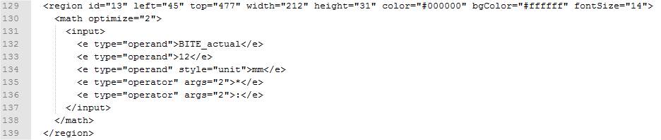

#9 Posted: 8/12/2012 3:22:04 AM
Hi
I can't replicate the issue but now I can confirm that there is something strange
In the attachments there are:
1) the source of your file as downloaded
2) the source of your file opened by SMath studio and saved on my PC
3) the correct source
I do not know how did your SMath create the script:
mm
regards,
w3b5urf3r
