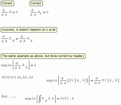

Please see attached example.

#3 Posted: 10/7/2019 10:07:31 PM
Alvaro Diaz Falconi
Alvaro Diaz Falconi
1,058 likes in 1,721 posts.
Hi Tom. maple() knows how to eval diff because, as plugin, Viacheslav (uni, plugin author) know how to handle the function el(A,k). But notice what happen with an unknoun function, like El(A,k). So, problem here is what to do with the SMath el(A,k) with the operator diff.

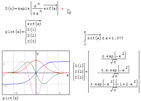

#4 Posted: 10/8/2019 6:14:03 AM
Get more from the companions ...

#6 Posted: 10/8/2019 11:35:59 AM
Igor Skarine
Igor Skarine
14 likes in 97 posts.
I think this is a bug.
If there is no evidence that variable A[k] depends on x, dA[k]/dx should be immediately set to 0.
This is the way how symbolic engine of Wolfram Mathematica works.
Probably, I made a mistake mentioning "indexed functions", the right subject name should be "indexed symbolic variables" instead.
In real case A[k] were indexed unknowns in the system of equations.
I intentionally made this example as simple as possible to make it evident.
#7 Posted: 10/8/2019 3:52:05 PM
You can do lot more from lot less for real project:
1. get your function from index
2. get the partial derivatives wrt parameters in function.
sym_diff_issue (more).sm (23.48 KiB) downloaded 555 time(s).
