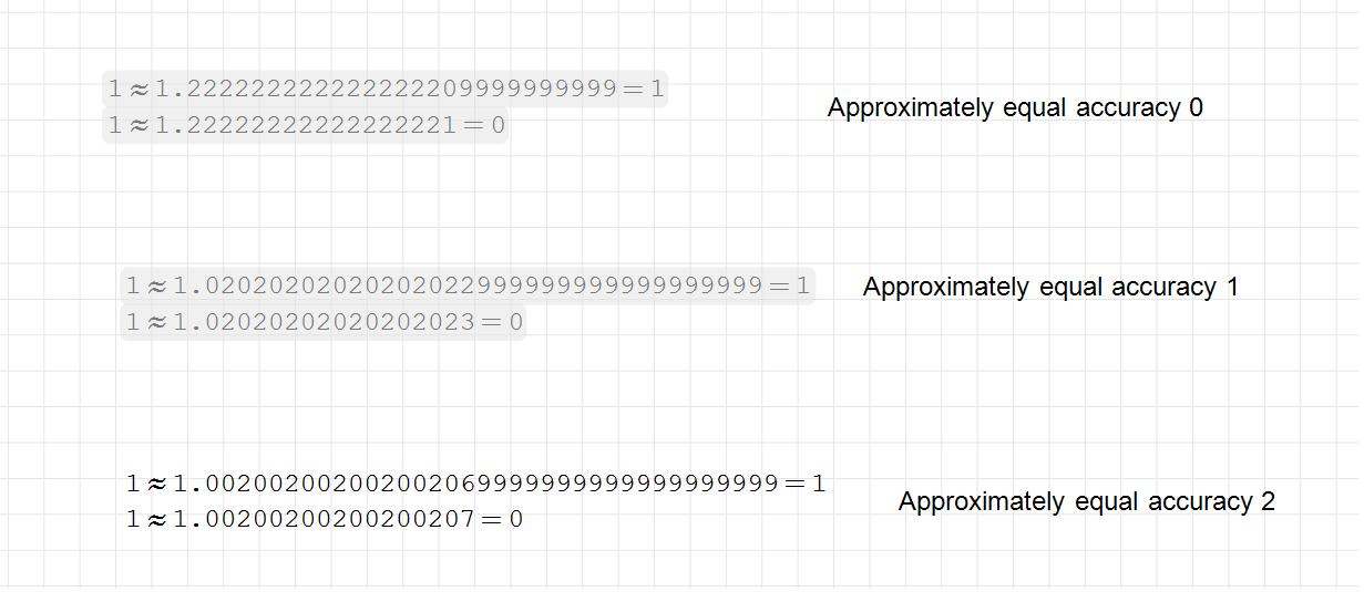

I see the "Approximately equal" operator accuracy varies from 0 to 15. What does this value actually represent?
#4 Posted: 6/20/2022 6:51:54 PM
2,343 likes in 4,043 posts.
Hi! It is an accuracy of the "Approximately equal" operator. F.e. if the accuracy is 0, then pi≈3, if 1, then pi≈3.1, if accuracy is set as 2, then pi≈3.14 etc.

It's more than just the decimal place precision.
approximately.sm (4.89 KiB) downloaded 1570 time(s).

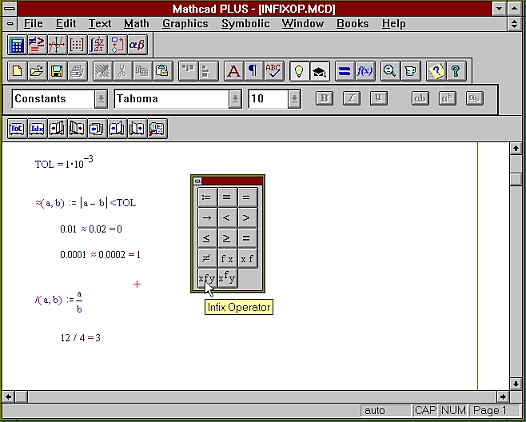

Hi. About the new approximately equal operator, another way to introduce it could be introducing a general infix operator, like in Mathcad. This screen capture is from Mathcad 6 running in Windows 3.11:
For work with units you just need to modify the rhs by abs( a-b ) < UnitsOf( a-b )*TOL (or maybe UoM). Notice that also can be a solution for another features requests, like this one about inline division: https://en.smath.com/forum/yaf_postst21614_Inline-division.aspx
About the "Defined Integral supports units now" it is a major improvement, and while there will be many worksheets to update, it is a substantial and very welcome improvement. I do think that some kind of special announcement should be made. Also, if you plan to also modify solve and roots to accept drives, you may want to introduce the two improvements together in a future stable beta release.

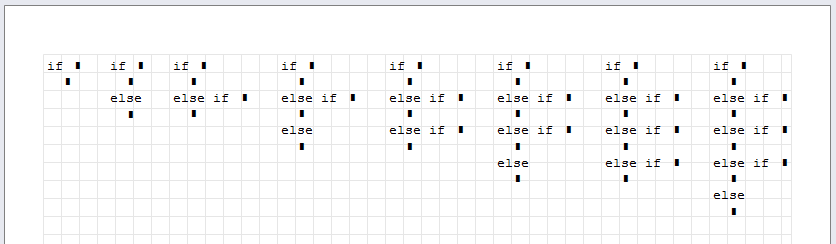

how to input else if? I use SMathStudioDesktop.1_0_8206.Mono
In the placeholders of the if() function type an "argument separator" symbol (comma or semicolon, usually)
The if without else will improve alot the readability of many scripts, thank you Andrey.

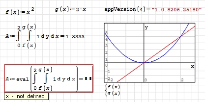

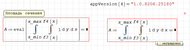

Перестали вычисляться безразмерные интегралы
#14 Posted: 7/4/2022 4:05:19 PM
Александр
Александр
0 likes in 10 posts.
Thank you. But the problem is not because of eval(). She's somewhere deeper. My f3(x) and f4(x) limits are ainterp() of the table data.

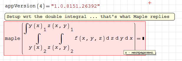

The question is why in the stable version integrals are calculated without problems, but in the new one it gives an error in the same places ?
In other words, you declare a bug.
Designers need the document for doctoring.
... doctor since which SS version ?
1.0.8151.26932 OK
1.0.8206.25180 NFG
Yes, I'm reporting a bug. In version 1.0.8151.26932, dimensionless integrals with limits in the form of arbitrary functions are calculated correctly. In version 1.0.8206.25180, such integrals are not evaluated. The error "x/y - undefined" is returned.
