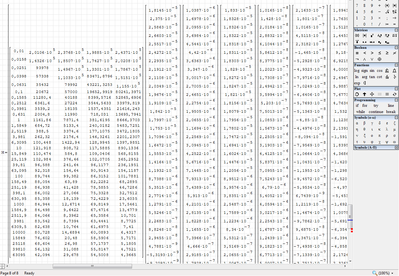

If I remove the " " and try to read it with rfile it gives the value 0.
The matrix I write is pretty big but here is what it looks like when I want to show it:
The number of lines matches.

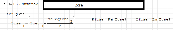

It is created via a succession of augment() of columns made of real and imaginary parts of complex arrays that are created line by line in a for loop, example for one of them here:
Giving you the .sm file would be complicated because of the plenty of files it opens...
But here is the output file I get:
mydata.7z (4.22 KiB) downloaded 614 time(s).
