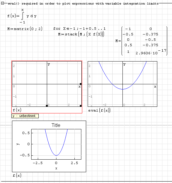

#20 Posted: 7/26/2013 6:17:28 AM
1,355 likes in 2,270 posts.
There still (as of 0.96.4909) seems to be a problem to plot functions involving definite integrals. You have to embed them into eval(), otherwise they give a useless error message (claiming that the integration variable is not defined)
The X-Y Plot plugin does not seem to have that problem. A workaround might be to apply eval() for expressions to be plot
by default. At least I am not aware of counter-indications.
