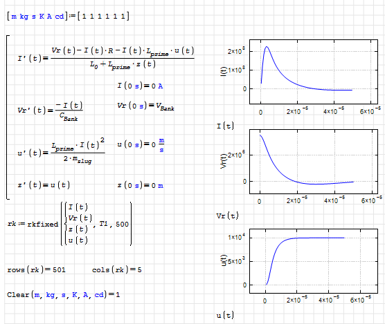

Hello SMATH Collaboratory,
I attempt to convert a Prime sheet to SMATH. The Prime sheet uses a solve block with "Odesolve" (pdf attached). I tried using "ODE2" but I do not have Maxima installed.
Is there another route?

Hi. You can try this. Even this returns functions for I(t), Vr(t) ... there is a unit issue. But you can use the values in rk with cinterp for reconstruct the functions with units.
Rail Gun ODE.sm (22.74 KiB) downloaded 650 time(s).

Hello Alvaro,
Awesome! Thank you, for your help!
