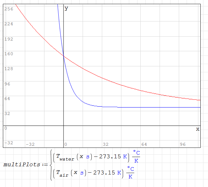

#9 Posted: 10/10/2022 5:06:00 PM
598 likes in 1,380 posts.
You can simply write as in plot below.
Just a reminder, since you are working with temperatures.
Temperature unit handling is different in SMath.
Addition of temperatures beside Kelvin should be done with delta units.
Otherwise, it will cause some unwanted complications.
