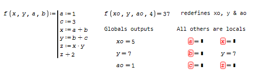

#8 Posted: 7/25/2023 11:36:58 PM
... I assume that above the maths you have shown in your post, you have separately defined xo:=5, y:=7 etc. ...
Hi. Nope. What you see is the entire worksheet, there are not hidden code there, sorry for not having attached it, for laziness. xo, y & ao turns global only after calling f(xo,y,ao). Before they could have some value or be undefined.
That ability to modify the values of the arguments passed to a function, whether or not they are defined, is unique to SMath and is not present in maple, mathematica or matlab, at least not in a simple way.
additional result.sm (6.99 KiB) downloaded 1258 time(s).
#9 Posted: 7/26/2023 1:49:02 AM
Peter Johns
Peter Johns
2 likes in 11 posts.
Alvaro,
I didn't know you could pass variable by reference, rather than by value, into a function.
I think that is a solution to the problem. It also has the advantage that it can insert all the variables into global scope in one go.

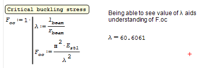

#12 Posted: 7/26/2023 6:55:23 PM
Casting the computations into block functions with no reference to context variables from inside removes any restrictions on variable names in the sheet. With a proper description such functions become self-documenting. This way you can create portable collections of such functions (and store them as snippets).
Blatt22.sm (5.76 KiB) downloaded 1288 time(s).
3 users liked this post
Oscar Campo 7/26/2023 6:58:00 PM, NDTM Amarasekera 7/26/2023 10:51:00 PM, Alvaro 7/27/2023 12:04:00 AM

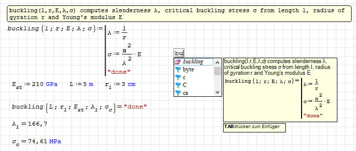

Hi. Pushing Martin's solution one little step further.
Blatt22 ver 2.sm (18.86 KiB) downloaded 1287 time(s).
Blatt22 ver 2.pdf (82.91 KiB) downloaded 779 time(s).

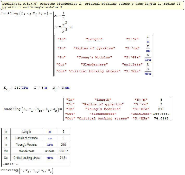

Here is a easy way to get a summary for procedural implementations of algorithms. You just insert a table region, write your function to the placeholder and do some format adjustments. In the example I just switched from fixed to variable width of table columns and set the font to arial.
Unfortunately, the decimal separator setting is not respected.
This procedure has full control over units in results display and can be extended to alvaros generalized approach (with then input and output flags being dynamic).
Blatt22.sm (12.98 KiB) downloaded 1299 time(s).
