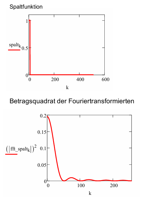

I have a Mathcad Document about Fourier transform that I want to translate into SMath.

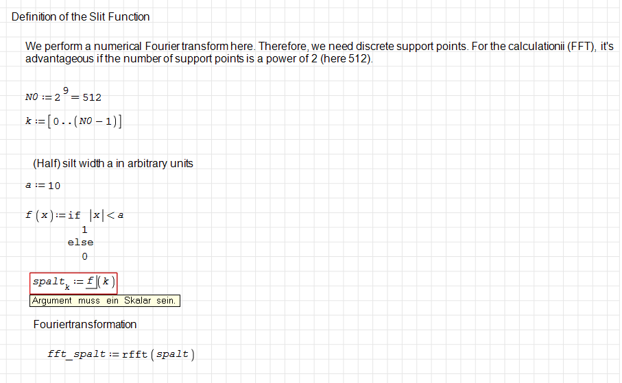

I already dowloaded the FFTPack plugin. I used the same functions from the Mathcad document which doesn't work in SMath.
I tried a bit but nothing is working. The error message says "The argument must be a scalar."
I attached screenshots from my SMath document and the original Mathcad document.
Does anyone have an idea or a helpful tip?

try to construct the vector like this

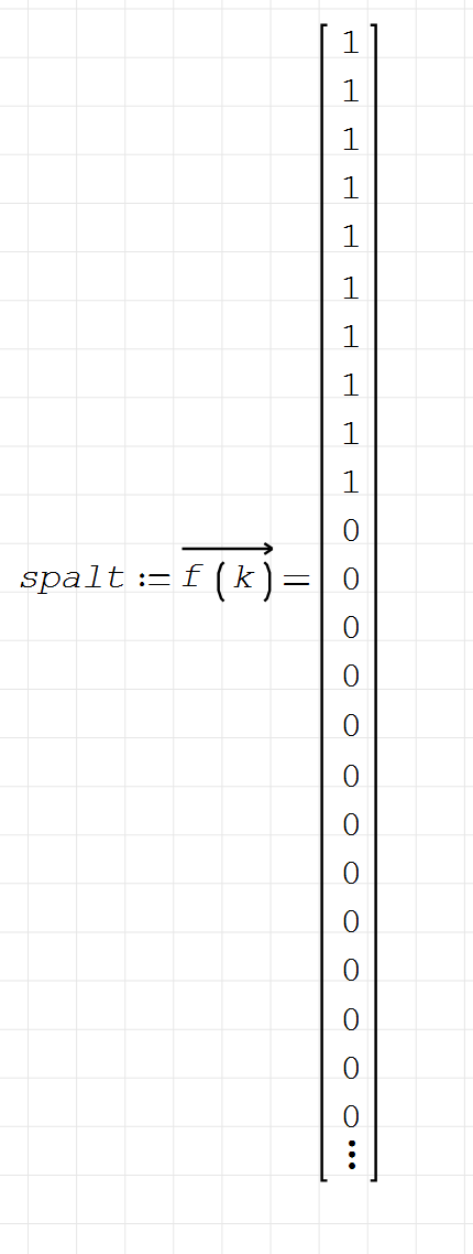

Thank you! That worked and the error message is gone.
I'm still having trouble plotting the graph. The graph is not being displayed but there isn't any error message.
