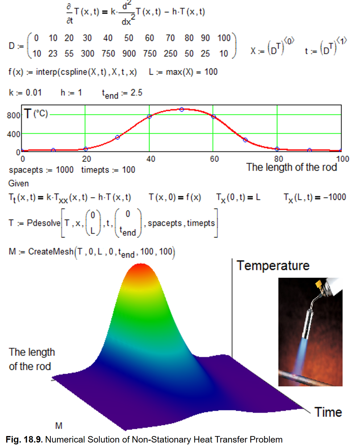

We heated the rod in the flame of a burner.
How will it cool down?
Non-stationary mode!

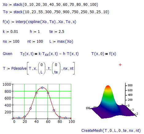

#5 Posted: 7/6/2023 7:22:21 AM
WroteFor your data set D ... 3 options:
1. Smath ainterp, cinterp ...integrate/solve(4)/zap derivative.
2. Mathcad l_p_c implemented Smath [1rst derivative, integration]
3. Thiele Smath ... symbolic derivative, integration.
If you have interest in methods [2,3] I will attach.
Since nearly ~ two weeks, Smath Studio can't be downloaded.
Replaced by Smath Solver ... a damned crippled version.
Cheers ... Jean.
Thanks!
I would like as here
https://en.smath.com/forum/yaf_postst23506_Cannot-plot-T-x--y.aspx
#6 Posted: 7/6/2023 9:53:10 AM
WroteThanks!
Thiele_0 Model QUICK.sm (24.5 KiB) downloaded 1349 time(s).
Maths EDU [l_p_c_splines TOOLBOX] Copy.sm (584.29 KiB) downloaded 1201 time(s).
These two documents are SS 6179.
Please, confirm you can open.

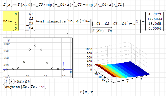

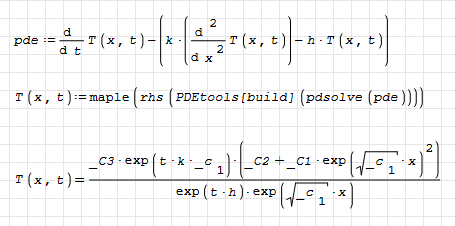

#7 Posted: 7/6/2023 2:33:10 PM
Wrote... And what about the ICs?
We must use one numeric not symbolic method!
Using maple, you can try to use a maple "component" or a maple plot, which gives more flexible access to maple structured functions.
Also, there are some numerical procedures for pde's in Maxima.
Notice that in Mathcad the border conditions for δT(x,t)/δx are not considered for obtain the solution.
With SMath, you can try to adjust the curve choosing good guess values in the yellow vector.
pdesol_num.sm (14.78 KiB) downloaded 1312 time(s).
