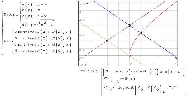

Hi. In the attached, can plot points and functions, but not both in the same plot.
Double Integral.sm (10.7 KiB) downloaded 679 time(s).

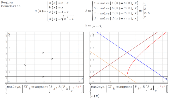

The old style works otherwise.
You can fill the region of integration.
Double Integral.sm (16.39 KiB) downloaded 674 time(s).
Double Integral FillRegion.sm (17.83 KiB) downloaded 649 time(s).

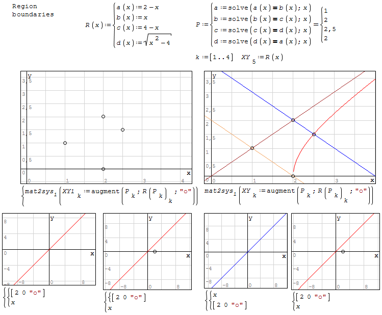

The behaviour of arguments in nested lists seems to be unpredictable, at least I don't see the rule.
Thus, re-arranging objects works but I don't know why.
Double%20Integral_Kr.sm (11.48 KiB) downloaded 787 time(s).

... personally: I prefer the more conventional form.
The example in view may fail in other instance(s).
3 in one: functions, solutions, fill-in region.
X_Y Plot wisely [Solve] Boundary.sm (39.51 KiB) downloaded 567 time(s).
