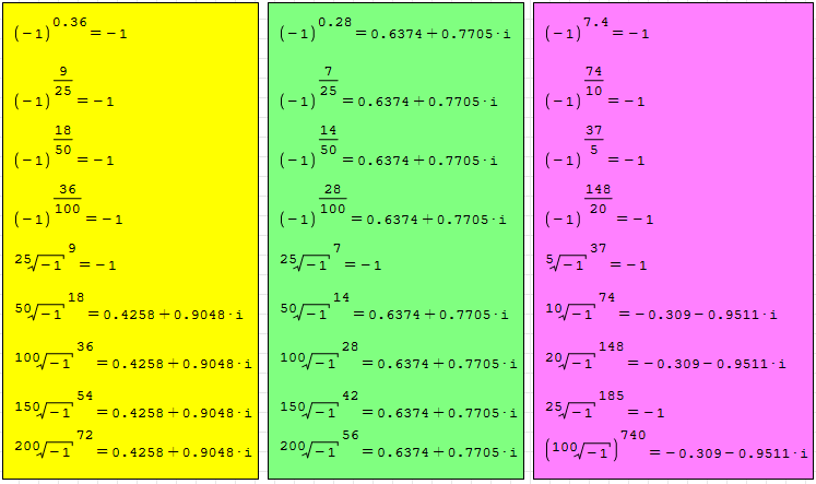

There is a bug I have encountered.
The result shouldn't be -1 or 1.
Result are correct for some not for others.
But we can't know when it is correct or not.

#2 Posted: 11/8/2021 10:27:09 PM
598 likes in 1,380 posts.
Not limited with exponents.
nthroot() suffers from this bug too.

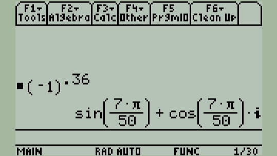

You are wrong.
Exponentiation of -1 or i has mathematical meaning.
What means is your calculators don't have rectangular form.
I don't care if it has practical usage or not.
Mathematics has it, period.
TI-89 Titanium:
Hackmath website:
https://www.hackmath.net/en/calculator/complex-number
