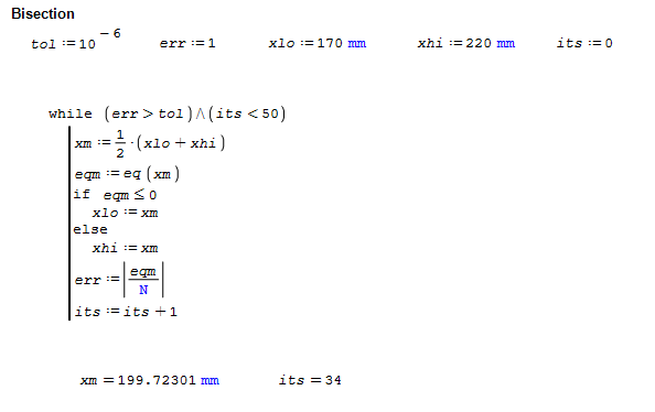

Here's a transparent, home grown bisection routine that does the job:
RC_forum_nonlinear_b.sm (79.46 KiB) downloaded 1555 time(s).
#3 Posted: 3/9/2024 1:48:11 PM
Many thanks for the quick solution.
I'll include the code in the inner loop of the procedure.

Thanks. Yes I've already correct the code.
My initial question was about the possibility to use built-in function, as it normally takes less time.
If there isn't this possibility, no problem. I can write alternative solution method.
I've implemented the quasi-Newton method (Broyden method - starting from Davide Carpi) to evaluate the best strategy regarding time and number of iterations.
Advice is always welcome.
Lorenzo

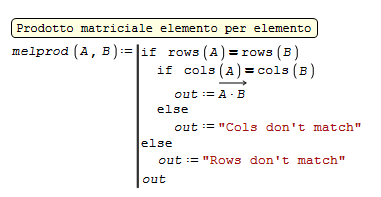

Thank you! With your improvement the speed is significantly increased
Wonderful
