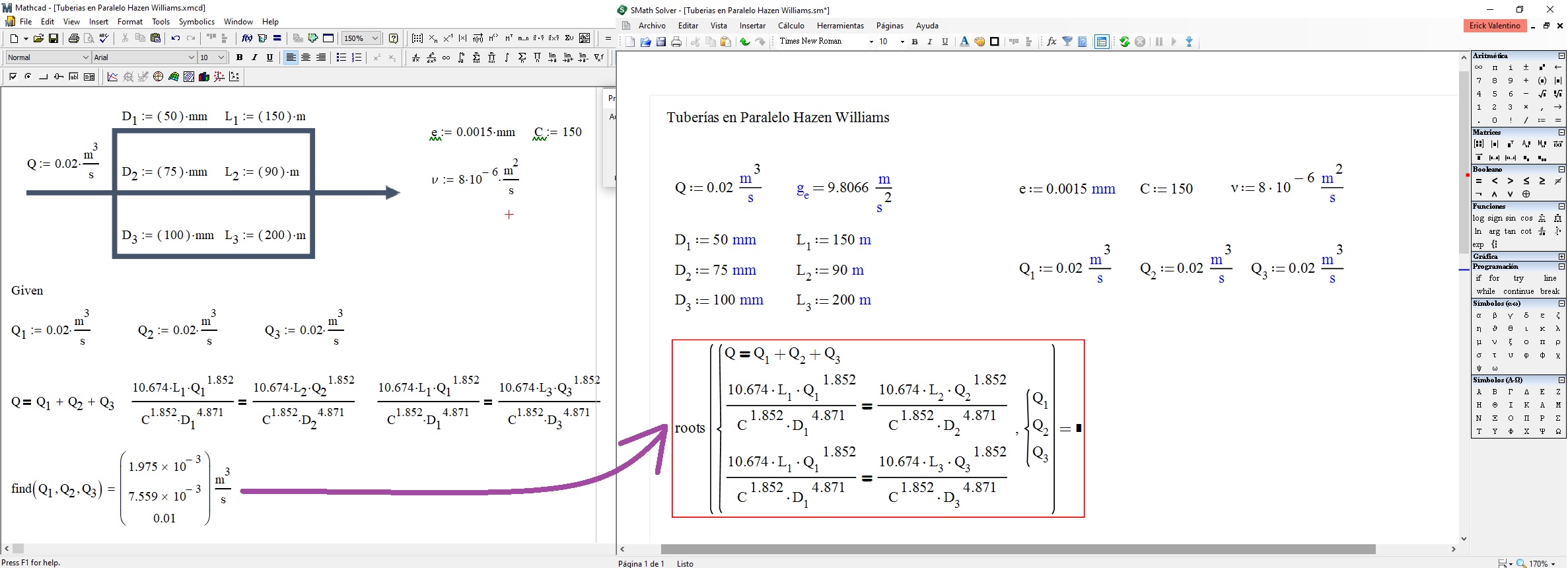

I would like to know how I can replace the "given" command from Mathcad to SmathStudio, I know that such a command does not exist in SMATH and for that there are other tools
I just need to find the flows Q1 Q2 and Q3 from a parallel pipe using the Hazen Williams equation, without having to do as many expressions

Tuberias en Paralelo Hazen Williams.sm (13.37 KiB) downloaded 1216 time(s).
Tuberias en Paralelo Hazen Williams.xmcd (26.7 KiB) downloaded 1229 time(s).

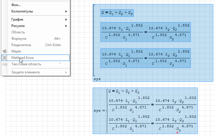

You can use Mathcad Block region for this.

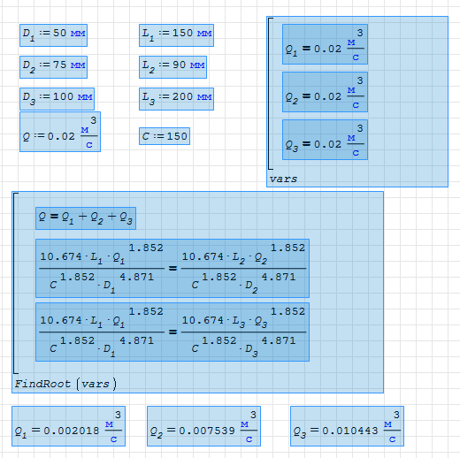

AFAIK, roots() won't work with units.
You can use FindRoots() for that purpose.
Regards.
tuberias.sm (11.75 KiB) downloaded 1240 time(s).

#4 Posted: 3/22/2022 5:35:27 PM
1,555 likes in 1,867 posts.
Or like this.
tuberias_uni.sm (12.14 KiB) downloaded 1205 time(s).

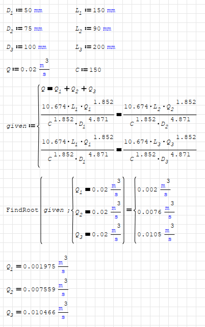

#5 Posted: 3/22/2022 8:59:10 PM
598 likes in 1,380 posts.
Or like this.
What the..? I didn't know you can use mathblock like this.
How FindRoot() can work under block with only one argument?
That is a very neat feature. Really appreciate you share this.
#6 Posted: 3/23/2022 12:32:03 AM
The first argument is implicitly substituted by the block itself. Then the function is called with two arguments.
