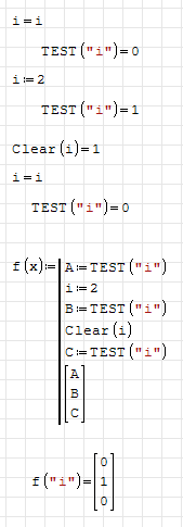

#2 Posted: 7/12/2017 12:43:25 PM
Hello Martin,
I still have the problem of identifying, where e and i are constants and where they are used as variables in expressions of arbitrary complexity. Is there any chance to do that in an elegant way?
what about this?
var i = new Entry("i";
var e = new Entry("e";
if (context.Contains(i))
    result = new Entry("1"; // variable has user-defined value
else
    result = new Entry("0"; // variable has default value
proof of concept:

#3 Posted: 7/12/2017 3:22:22 PM
Hello Davide,
thank you for your example, this gives insight into the use of the Store object and Entry().
I have to check if i or e really make it into the context when they are used as loop variables in sums which smath can't handle (if NotDefinedException is thrown by the preprocessor). Only in that case, the context.Contains() test would be a solution, because the problem also arises when e and i aren't re-defined outside the current expression.
Martin
