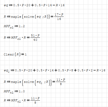

he first formula calculated well.
The second formula did not calculate.
The result is "The stack is empty."
What is the problem?

Either clear R or use a different variable name, R.1 for example.
Because you defined R at upper calculation, it confuses solvers.
