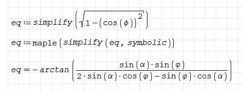

Wrotejust avoid to use that 'phi' (j Ctrl-G):
Is it only valid for Windows?
Linux mono doesn't have this problem.

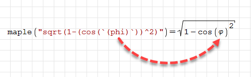

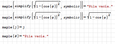

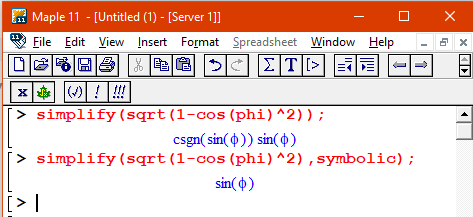

WroteObviously not, but the bug isn't that obvious: just avoid to use that 'phi' (j Ctrl-G)
Yes, these are different letters:
cos(ϕ) and cos(φ)
maple() works with φ
This was done to unambiguously convert variables into Greek letters:
maple() function uses implicit encoding of Greek letters:
