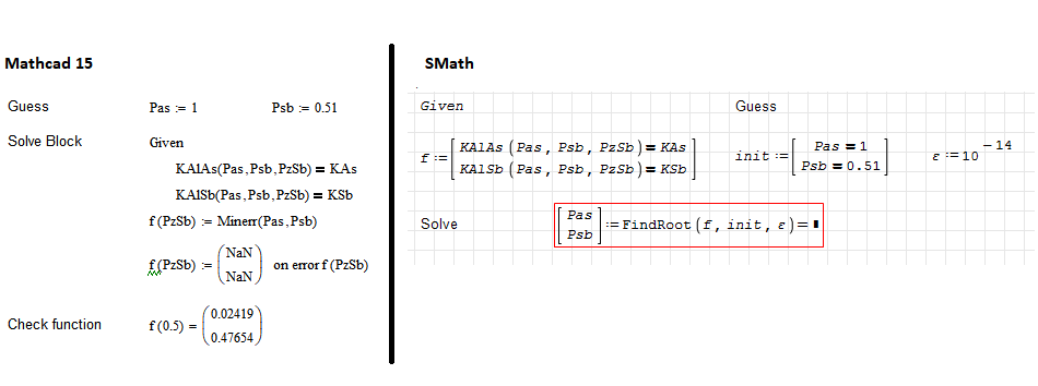

Hello everybody,
I am migrating to SMath from Mathcad 15 and I would appreciate a jump start in converting a solver into SMath as I am not yet familiar with all the details of SMath.
The problem is an exercise in thermodynamics with the calculation of a solid composition from a gas mixture.
Mathcad uses a solve block. I understood I need to convert it into a matrix.
Mathcad file (pdf format), the SMath sheet, and a summary are attached.
Thanks for the help

Hi. This could be an option, using the non linear solver from alglib plugin.
pTM AlAsSb 3.0 auto v1 2020-04-26.sm (27.52 KiB) downloaded 1295 time(s).

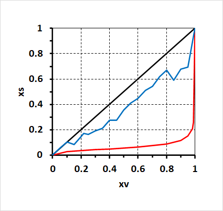

Hi. This is a way to make the plots.
pTM AlAsSb 3.0 auto v1 2020-04-26_plot.sm (50.55 KiB) downloaded 1271 time(s).
pTM AlAsSb 3.0 auto v1 2020-04-26_plot.pdf (165.06 KiB) downloaded 762 time(s).

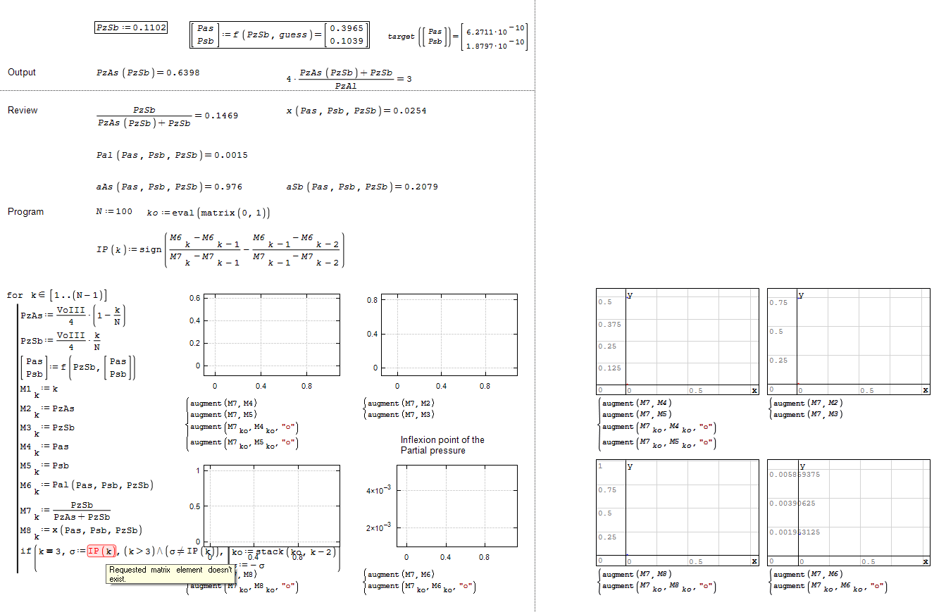

Ahora, intento hacer un cambio de materiales, y lo consegui hasta la funccion que da los valores uno por uno.
Un parametros es borrado.
Obviamente, necesito hacer tambien cambios en el programa y los indejos de IP.
Pero no se leer las lineas siguentes
if(((ko≡0)&(k>2))&IP(k),ko:k-2,continue)
Y no entiendo como hacer los cambios indejos en IP(k).
Puedes explicarmelo por favor?
Necesito el entendimiento para los graficos
Gracias
Pedro
En ingles:
Now, the parameters of the problem have changed as the material is different.
I have achieved to make the change up to the definition of the function that give the single values.
There is one parameter less.
Obviously, I have to make the necessary changes in the program and to the indexes.
But I don't know how to read
And what's the exact purpose of IP(k)
Can you please explain them?
I need to understand the concepts in order to make the changes for plotting the data.
Thanks,
Pierre

Hola Pedro. Feliz año, igualmente. El problema a resolver es hallar el punto de inflexión de la curva dada por (x,y) = (M7,M6). Esto puede hacerse derivando M6 respecto a M7 y hallando los ceros de esa derivada, lo cual no parece algo fácil de hacer, ni siquiera numéricamente. Otra aproximación es discretizar sobre un índice, en este caso k, y detectar a partir de la definición de concavidad el momento en que ésta cambia, lo cual es la definición de punto de inflexión y es lo que se evalúa con IP(k). Para detectarlo y almacenarlo en ko, es la línea
Primero preguntas si ko es cero, por lo cual es el primer punto de inflexión, si k > 2 para asegurarte que puedas evaluar IP(k), pues IP(1) y IP(2) dan error, y finalmente si IP(k) = 1 (se puede omitir el igual a uno). Si las 3 preguntas son ciertas guardas k - 2 en ko, y si no continúas el lazo.
Esta otra versión hace más o menos lo mismo, excepto que detecta los dos puntos de inflexión.
pTM AlAsSb 3.0 auto v1 2020-04-26_plot 2 inflex.sm (51.41 KiB) downloaded 1284 time(s).
Espero eso explique el algoritmo.
Saludos cordiales.

Hola Alvaro,
* Intente resolver la hoja del compuesto binario pero hay un error que no entiendo.
"result is above max allowed positive number" en el bucle
Pero la funcion f por si sola da una respuesta sensata.
Es en el bucle que f no parece funccionar
Averigue como solucionar el error con eval y Optimization / Numeric, pero no resolvio el error.
(Y ahora encontraras eval por todos los lugares).
* Anade lo siguente
- Una matriz 2D replaza a los vectores M1...M8. Lo necesito para guardar my datos en la computadora.
- Los desconozidos han de ser positivos para tener un sentido fisico. De vez en cuando aparecen como negativos y tengo que rechazarlos.
(De vez en cuando, (pzi-pi) es un negativo y tengo tambien que rechazarlo).
Es possible incorporar esa restriccion al progama ?
- La matriz es exportada al final
- El nombre del fichero es contruido con los parametros del experimento
* La hoja del ternario AlAsSb con el indice IP para detectar los dos puntos de inflexion no funciono con mi computadora.
Gracias,
Pedro
* I came across this error when tayloring the worksheet to the binary:
"result is above max allowed positive number" for the Loop
But the function f appears fine for the first pass out of the loop.
The error seems to be with the loop.
The recomanded method for the resolution of the issue is using eval and switch to a numeric optimization.
But it didn't help. I left in the worksheet many eval requests.
* Few changes have been made to the program
- The many vectors have been replaced by a single 2D matrix for convenience.
- Unkown pA and pB must be positive numbers to keep a physical meaning.
Every so often, negative numbers show up as solutions and I have to discard the result.
Sometimes pzi - pi is negative and the solution is rejected.
Can the constraints be incorporated to the program ?
- The matrix is saved after the calculation
- The filename is built from the experiment parameters.
Thanks again for the help,
VSD06 G14 12 Binary.sm (46.46 KiB) downloaded 1168 time(s).

Hello all,
Here is a revised worksheet.
* Parameters are in matrix format (pz, Mp) for a more condensed program (later "if" test of negative values is in loop)
* First pass is using as a guess the solution calculated for the definition of the function.
* Next pass in the loop is using the previous solution as a guess
* The issue is with the use of the function in the loop. The error goes away once removed.
Thanks for helping
Pierre
VSD06 G14 12 Binary.sm (55.61 KiB) downloaded 1198 time(s).

You may want testing try on error from f(x) menu
#13 Posted: 1/10/2023 4:08:21 PM
Hello All,
Try / on error does something. The error vanished.
But I am still getting nothing.
How to I get to display the result matrix out of the program ?
The file doesn't appear to save. Maybe it's an empty matrix ?
How is the plot defined from a 2D matrix?
Thanks for the help,
PierreVSD06 G14 12 BNR rev.sm (46.53 KiB) downloaded 1266 time(s).

Hi. In your original version you have M6 = Pal( Pas,Psb,PzSb ) and M7 = PzSb/{PzAs+PzSb}, but now you don't have that function anymore for the partial pressures, and M7 = x(...). So, basically, you're solving a very different problem now and can't use the same steps in the loop. Unlike the previous problem, which was a fairly well-known case study in process engineering, I am not able to identify what type of problem this new approach addresses.
About the error in the image from your previous posts, it seems that you are using an old SMath version, which does not have the option for use 'if' with only two arguments.

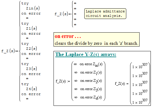

WroteTry / on error does something. The error vanished.
Mathcad uses NaN [Not a Number]
T,G has used ^-307 as NaN
I suspect Smath Try on error is 10^-15 or close
