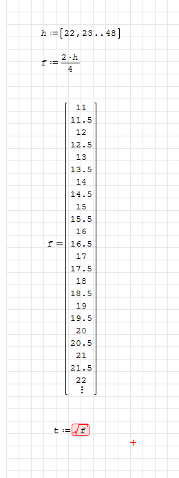

Hi, I'm a new user of smath and have come across an issue when I try to calculate the sqrt for a range of values, I just get a message saying that smath is unable to calculate. Attached is an image of a simple sheet showing what I am trying to achieve, ideally I wouldn't have interim values for f listed root problem.PNG
Any help gratefully received.

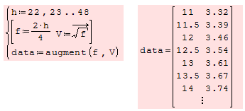

#3 Posted: 12/9/2019 9:24:11 PM
983 likes in 6866 posts.
Simply like this.
