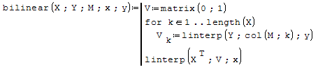

could you please suggest an efficient bilinear interpolation algorithm?
Now I use this rather ugly ang inefficient function, that will take forever (see attachment).
To make this more efficient, I must look for two adjacent columns and two adjacent rows, taking into account possible unsorted input, possibly outside position (extrapolation) and possible perfect match. This will likely be slow, too. Maybe there's any better approach?
Thank you.

#2 Posted: 2/20/2014 5:09:03 PM
Thanks, Ioan,
the matrix(0,1) thing here is for those cases when V happens to be defined outside, thus being non-local variable. So here we effectively clear it (and ensure proper matrix type and dimension, while being empty). Otherwise, this may give unexpected results (if V is vector with more than length(X) rows), or errors (if V is not an array).
Other solution (though not bullet-proof) would be using some very strange and hardly-reusable name (like bilinear_local_V).
Yet another (and preferrable) would be a means to define V as local-only variable...

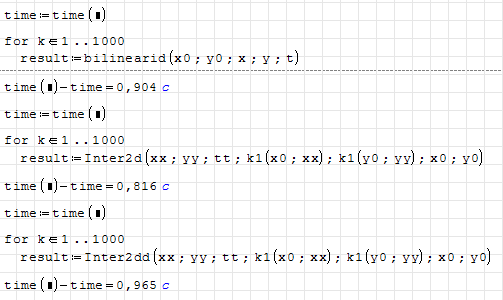

Here is a typical result on my computer (using your sample data). The results are consistently reproducible (±0.010s)
Notably slower is (surprisingly) Inter2dd, while Inter2d is steadily faster (though not that much faster - I suppose that further optimisation could give greater boost) than my variant. I wonder why these two almost identical functions work so differently in terms of performance?
I didn't test for corner cases yet. Also, larger tables should be tested as well.

#4 Posted: 2/20/2014 10:13:53 PM
As for me the fastest is bilinearid followed by Inter2dd...
Sometimes seems to me that performances are also affected by the position... if I place my InterBil on top or on the bottom of the list below I can see an high difference...

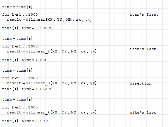

#9 Posted: 2/21/2014 7:32:16 PM
I've added a rude implementation of the Ioan "bilinear-final i" solution in my custom functions plugin... seems quite fast, someone can test it?
function: InterpBilinear(row X,column Y,matrix M,number x,number y)
BTW to improve the margin() performances on large matrices, if we assume that the X and Y vectors are both sorted, a way could be to use a "divide and conquer" algorithm (basically, a bisection through the vectors indices)

#13 Posted: 2/22/2014 7:53:47 AM
A test through the Margin() solutions... BTW IMHO is preferable a test with less iterations but bigger matrices...
[edit 1] file updated (previously missing xx and yy values on the canvas)
[edit 2] screenshot updated using the file above
