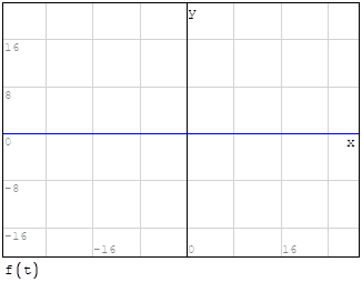

When I right click on the graph and try to animate, I get "t not defined."

WroteWhen I try to animate, I get "t not defined."
SS 6179 is more convivial:
"plot then define animation variable"
Click over the plot then set the animation, variable.
#3 Posted: 7/10/2023 5:54:10 PM
I right click on the graph and then select animate t.
I select 2 frames per second.
Still get error, t not defined.

Hi Lee. This is an example about how to animate a path in the plane. What kind of animation do you want to get?
