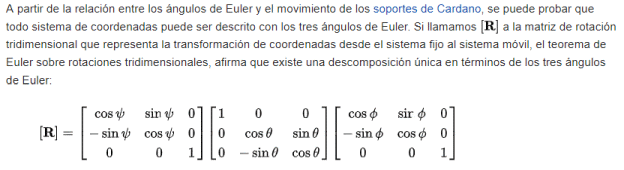

Using SMath convention for axis it's very difficult to me, and also add the fact that in Latin America we use this as Euler angles:
https://es.wikipedia.org/wiki/%C3%81ngulos_de_Euler

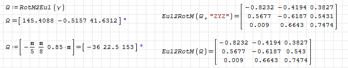

In the attached, I can invert emulating the matlab robots toolbox's rotm2eul.m function, but notice that I need to swap the product order to get the same matrix with those angles that I obtain first.
So, I don't sure now if we are doing the rotations ok taking Ω1*Ω2*Ω3 or, for SMath, the correct order is Ω3*Ω2*Ω1, and this swap is the math meaning for "left coordinate system".

WroteSo, I'm not sure now if we are doing the rotations ok taking Ω1*Ω2*Ω3 or, for SMath, the correct order is Ω3*Ω2*Ω1, and this swap is the math meaning for "left coordinate system".
Euler traditional [Roll, Pitch, Yaw] is not commutative once angles are defined.
Some 3D solids will show convenient in any of the possible 3! = 6 commutative.
Rotate Euler NOT Commutative.sm (16.33 KiB) downloaded 1062 time(s).
