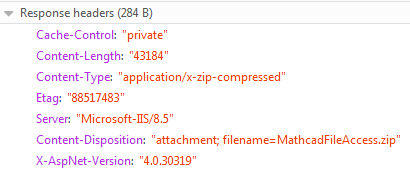

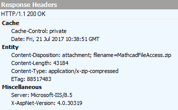

I can't access the server configuration but are you sure about the header?
I see it is a legit application/x-zip-compressed, both from executable and from browser

You were right, I have the same header (application/x-zip-compressed) info in firebug as well. Firewall's 403 error page misled me:
Policy warning: Proceed with caution
Website: http://smath.info/file/HzaDH/MathcadFileAccess.zip
Reason: Download content type is "application/x-dosexec"
Thank you for your help! I think there is nothing I can do here.
