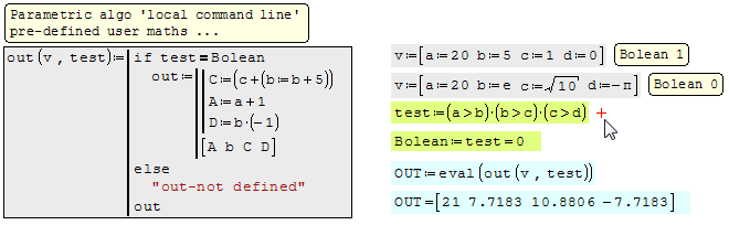

#2 Posted: 4/6/2023 7:44:47 PM
WroteHow can you write multiple conditions ...
If you want to piece wise plot conditional ...
if/otherwise ... as any as you want to condition.
From the directed visit Samples, iterative is bidirectional.
Or multiple conditional Golden ratio
More advanced conditional is generally Bolean... Example attached.
Show something of your Creation.
Cheers ... Jean.
Critical Triplet Demo.sm (16.26 KiB) downloaded 1321 time(s).

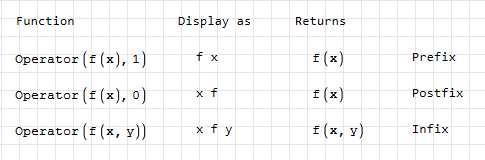

WroteHi Davide. Something like this other?
this maybe?
also, prefix/postfix functions can be made for unlimited arguments.
I've tried something like postfix(F,x,y) but it isn't really user-friendly (e.g. it can't be used on the LHS of an assignment because it overvrites the postfix() function itself)
Alvaro 4/18/2023 12:22:00 PM
#15 Posted: 4/18/2023 12:25:44 PM
Wrote... this maybe? ..
Hi Davide. Great implementation. But I'm thinking in ways to write set union a U b, intersection, function composition like f o g (x) := f(g(x)), logical binary operators like implies, iif and similar stuff.
