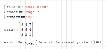

Greetings to all, thank you very much for this opportunity to be here in this forum,
I have tried to solve this problem, thank you very much for your comments and success to all.

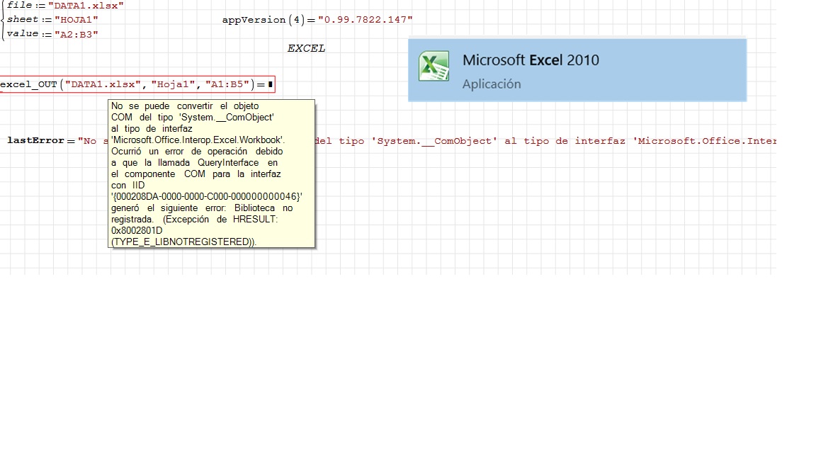

Ricardo, at first, I would say the issue is the "x" in ".xlsx" being in uppercase,
but I can't make this plugin nor Clipboad Region work after the last update,
so maybe the real plugin are within the plugins themselves.

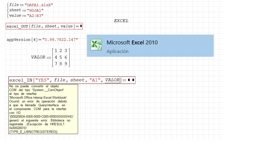

ERROR-OUT EXCEL.jpgMuchas Gracias por su respuesta, Eng. João Felipe Melo es una sorpresa la respuesta de su persona.
Sigo y veo los videos en su canal YouTube. Mil gracias nuevamente.
Éxitos siempre.
Thank you very much for your response, your response is a surprise.
I follow and watch the videos on your YouTube channel. Thank you again.
Successes always
Muito obrigado pela sua resposta, sua resposta é uma surpresa.
Eu sigo e assisto os vídeos em seu canal no YouTube. Obrigado novamente.
Sucessos sempre.
Rikardo21

Meanwhile you can install DataExchange plugin.
There is exportData.XLSX() in it.
That function maybe can help you.

overlord: Thank you very much for your reply.
The plugin does work.
use "DataExchange plugin",
question:
some replacement for the "Excel_PNG()" plugins
Thank you very much for your support. to all.
Rikardo21

I have not been able to reproduce this problem in my environment. Could you please attach the contents of the XLSXupdate.log file that appears when the program starts?
The path is: %appdata%\SMath\extensions\plugins\e40eaef6-4622-4ef3-ad03-077e8f005bb1\x.x.x.x\ (x.x.x.x - the plugin version)
