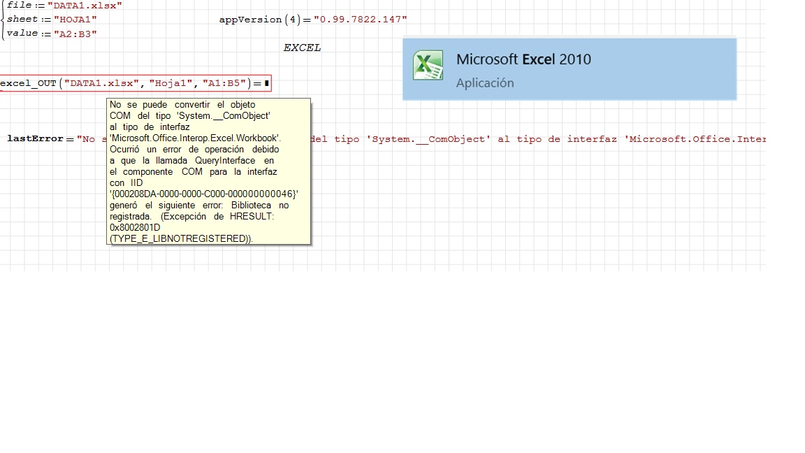

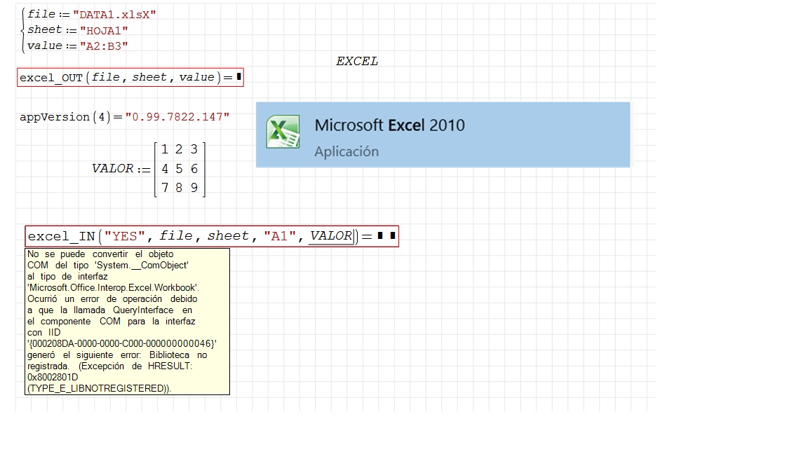

#97 Опубликовано: 20.09.2021 11:55:25
Ricardo_Herrera
Ricardo_Herrera
1 сообщений из 8 понравились пользователям.
ERROR-OUT EXCEL.jpgMuchas Gracias por su respuesta, Eng. João Felipe Melo es una sorpresa la respuesta de su persona.
Sigo y veo los videos en su canal YouTube. Mil gracias nuevamente.
Éxitos siempre.
Thank you very much for your response, your response is a surprise.
I follow and watch the videos on your YouTube channel. Thank you again.
Successes always
Muito obrigado pela sua resposta, sua resposta é uma surpresa.
Eu sigo e assisto os vídeos em seu canal no YouTube. Obrigado novamente.
Sucessos sempre.
Rikardo21

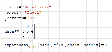

#98 Опубликовано: 20.09.2021 12:53:08
Greetings to all, thank you very much for this opportunity to be here in this forum,
I have tried to solve this problem, thank you very much for your comments and success to all.
I couldn't make the plugin work either.
Meanwhile you can install DataExchange plugin.
There is exportData.XLSX() in it.
That function maybe can help you.
#99 Опубликовано: 20.09.2021 13:15:24
Ricardo_Herrera
Ricardo_Herrera
overlord: Thank you very much for your reply.
The plugin does work.
use "DataExchange plugin",
question:
some replacement for the "Excel_PNG()" plugins
Thank you very much for your support. to all.
Rikardo21
