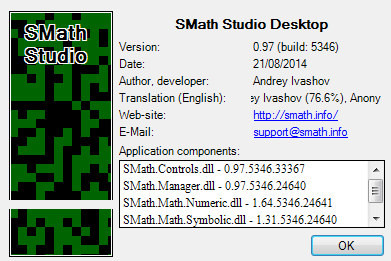

Hello E-Jay, what version of SMath Studio version are you using?
#3 Posted: 9/9/2014 1:15:53 PM
Jay May
Jay May
3 likes in 10 posts.
Version: 0.97 (build: 5154)
Date: 2/10/2014
