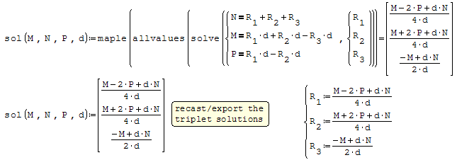

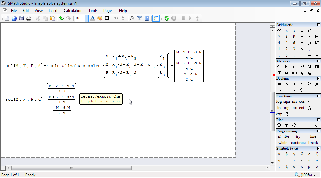

#5 Posted: 8/24/2021 12:29:48 PM
#6 Posted: 8/24/2021 12:57:45 PM
#7 Posted: 8/24/2021 2:22:42 PM
kompre,
You can use the Solve command of the maxima plugin. maxima_Solve_system.sm (7.91 KiB) downloaded 1182 time(s).
P.S. I believe that Jean's solution is not correct because the solutions are not ordered
