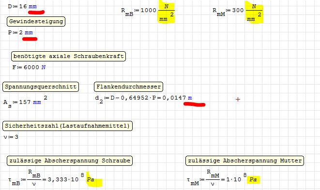

Hello Jonny,
Units in results are by default in base units. You can set the more appropriate units for the single result writing in the rightmost placeholder (wiki: units)
If you are interested to have default output units you can register in the Bug Tracker System and vote SS-1
