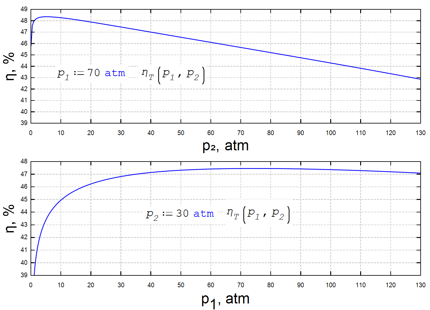

I have f(x, y) - thermal efficiency of a steam turbine with two steam extractions for heating feed water depending on the extraction pressures.
Question.
1. How to find the optimal pressure values at which the efficiency will be maximum?
2. Is it possible to build a surface? For now I have two separate 2D graphics.

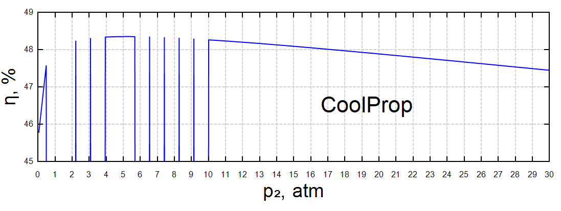

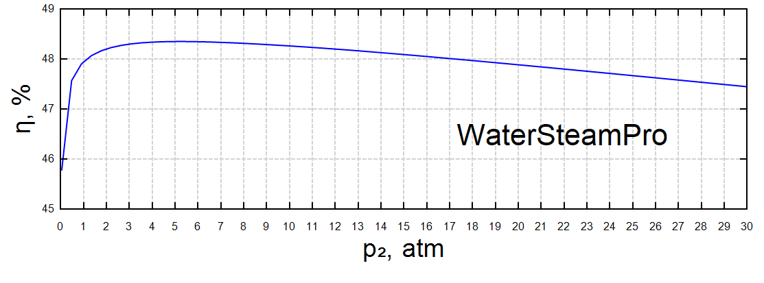

No, you cannot replace WaterSteamPro with Cool Prop for water/steam.
WaterSteamPro is a certified program!
Compare please two plots

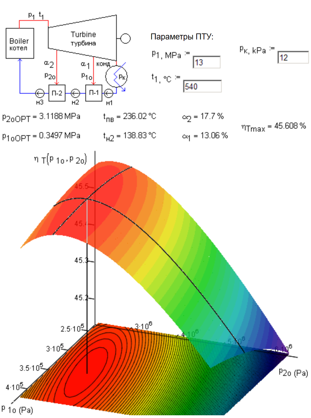

Martin (and all), I am waiting for the solution - 3D-plot and optimal values of p1 and p2.

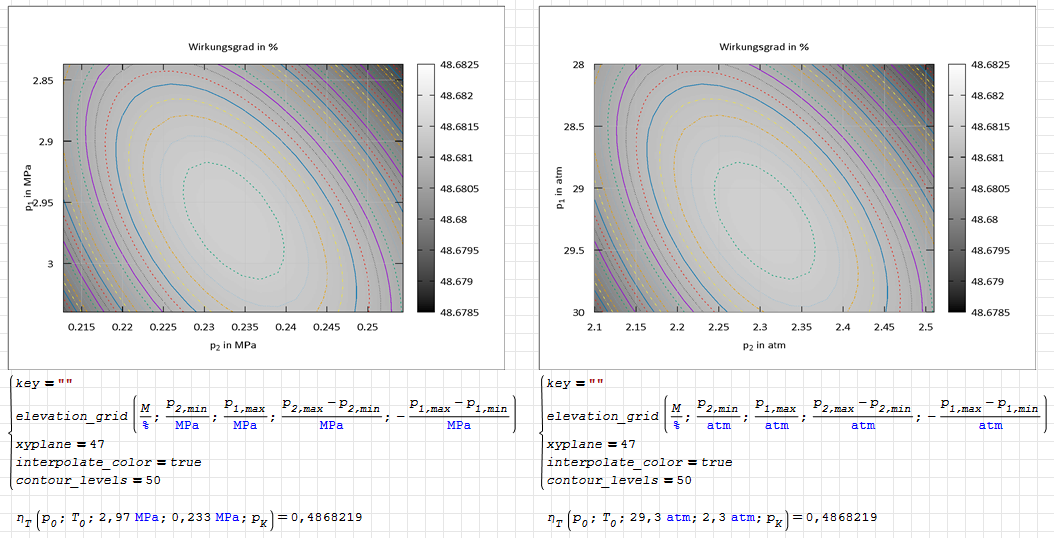

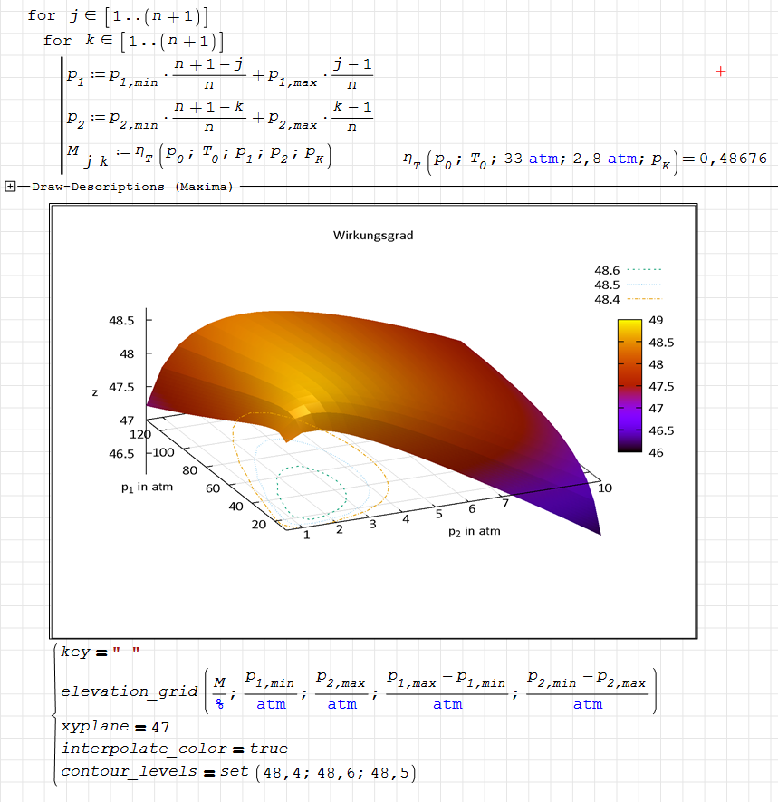

#7 Posted: 11/8/2023 9:11:41 PM
Just the plot, no optimization yet.
2RegP-Ideal-Cool_Prop-95_Kr.sm (300.35 KiB) downloaded 1472 time(s).

#8 Posted: 11/9/2023 1:16:22 AM
Valery Ochkov
Valery Ochkov
66 likes in 697 posts.
No optimization yet.

#9 Posted: 11/9/2023 6:31:08 PM
Agreed: CoolProp is CoolProp.

I get slightly different values. Still no automatic optimization because the objective function doesn't translate to Maxima. As a first step I made the function more robust by solving the two equations sequentially instead of simultaneously. In the original version sampling for the plot occasionally failed.
Plot MPa.pdf (219.47 KiB) downloaded 842 time(s).
2RegP-Ideal-Cool_Prop-95_Kr_detail.sm (157.12 KiB) downloaded 1490 time(s).
2023-11-11 19_21_55-SMath Solver - [2RegP-Ideal-Cool_Prop-95_Kr_detail.sm_].png
2RegP-Ideal-Cool_Prop-95_Kr_detail.pdf (520.5 KiB) downloaded 840 time(s).
Valery Ochkov 11/12/2023 2:41:00 AM, Alvaro 11/12/2023 9:04:00 AM

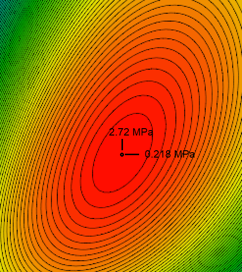

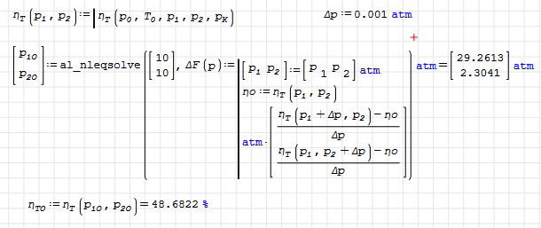

I get slightly different values. ...
Hi. Using the definition for partial derivatives and a pure numerical solver.
2RegP-Ideal-Cool_Prop-95_Kr_detail.sm (162.36 KiB) downloaded 1410 time(s).
