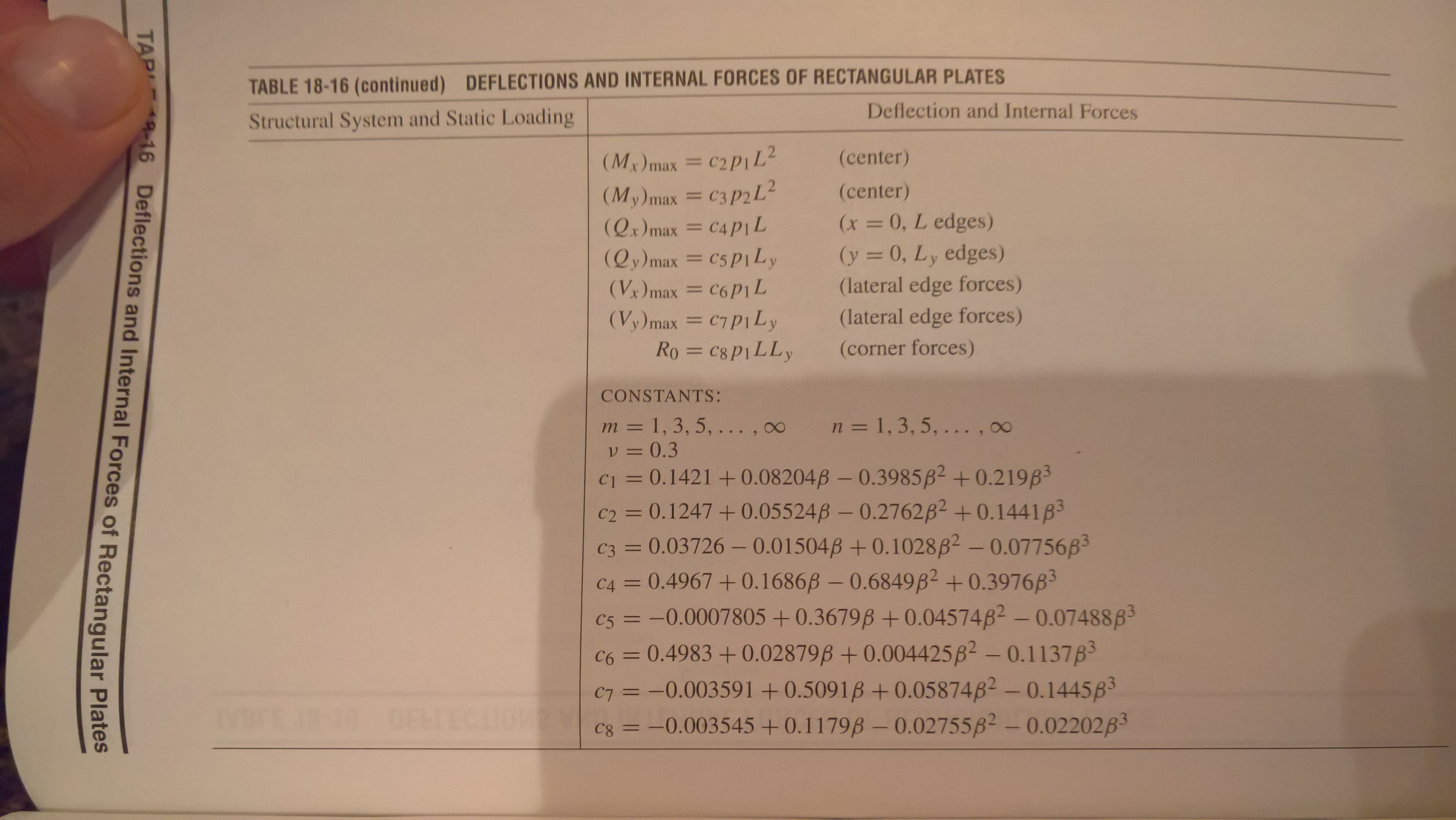

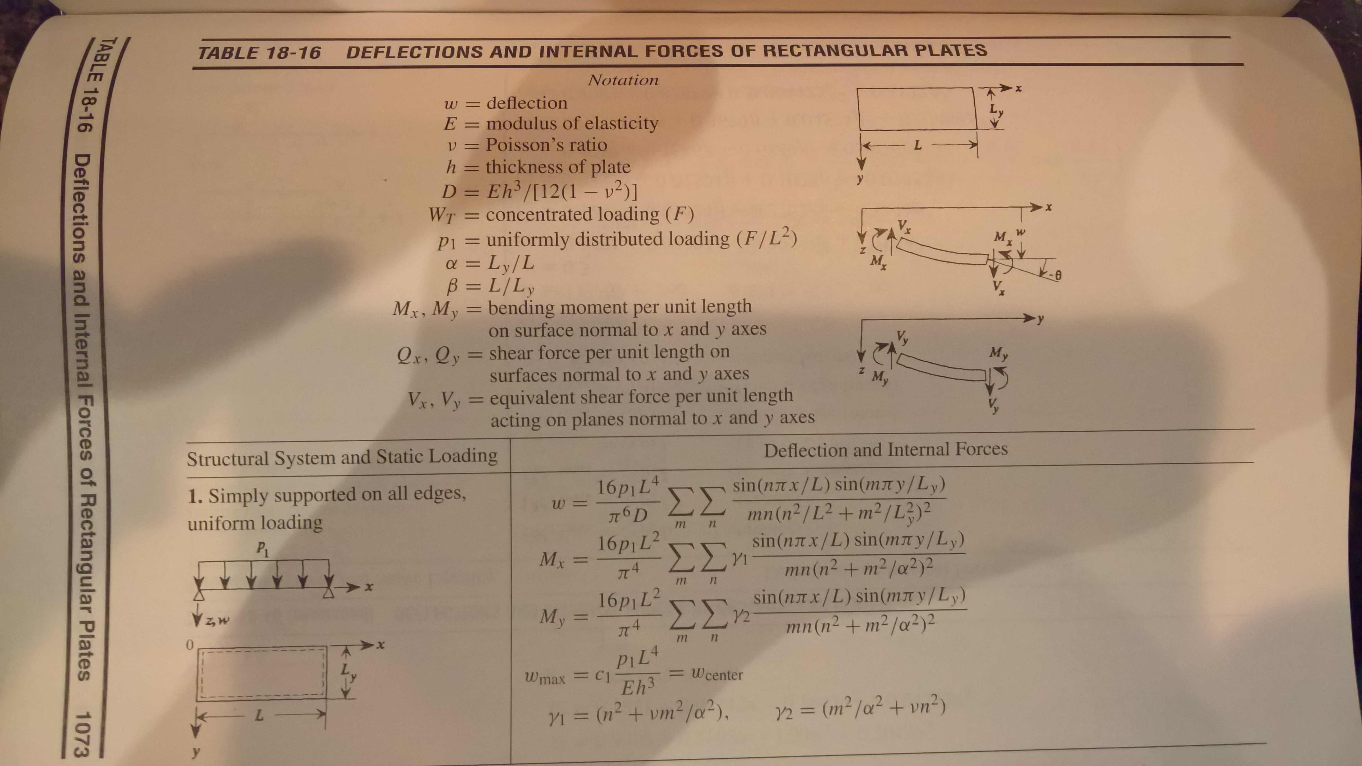

I am trying to use some internal force and deflection tables from a textbook for plates. Attached are the equations for moment, shear, deflection, etc. Is it possible for me to write this equation using double summation and the constants for m, n which are odd numbers to infinity?

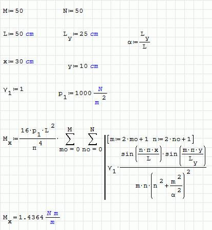

Sure. Just take odd numbers.

Thanks for the help. Not sure why I got so hung up on this. Seems relatively easy now...
