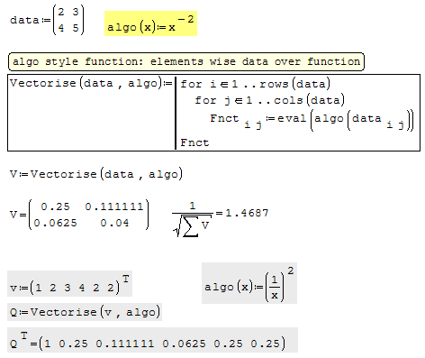

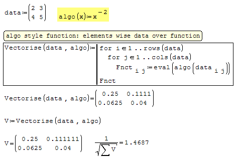

#22 Posted: 3/9/2016 1:28:52 AM
Sergio,
Your example that works elements wise, check for other issue:
vectorise as you did ... SQRT( ... result at the bottom of
the attached work sheet in light red.
Utilities Matrix Vectorise EXPRESS.sm (56.49 KiB) downloaded 1405 time(s).
... read more as well.

Jean,
thanks a lot for sharing ...your approach with the algo technique of passing a function ..to a function is very interesting .
It is something I had never thought that was possible to do, it is very elegant and concise.
Thanks again and best regards
Franco

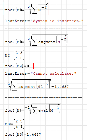

I'm not sure if this had been asked:
Currently, it's impossible to create a function like
f(M)=sum(M)
because sum takes only matrices, and M here is unknown type.
Using, say, augment(), which return type is known to be a matrix, I can do this:
f(M)=sum(augment(M))
I cannot use vectorize(), because its return type may be scalar like in vectorize(1), or system.
Though I can use it with eval().
The question is, is it possible to make vectorize always return matrix? When argument is a operation on system, for example, the result type differs from input. Having this could allow for such constructs without evals.
Or maybe allow sum to accept any type of input, making it return input itself if it's scalar/system/string?
С уважением, Михаил Каганский

It is unfortunate that eval() prevents vectorize() from evaluating its arguments one-by-one.
For example:
f(x):=(1/x)^2
vectorize(mat(1,2,3,4,2,2))=mat(1,0.25,0.1111,0.0625,2,2)
f(x):eval((1/x)^2)
vectorize(mat(1,2,3,4,2,2))=mat(5.5,-2.5,-3.75,1.75,2,2)
If the expression of vectorize is optimized before by-element evaluation, then it's impossible to use, say, linterp() in such functions, and eval doesn't help.

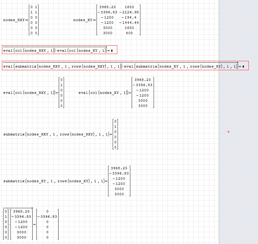

About foo1 and foo2 you can avoid the evaluation on assignment using a programming function (line()); no ways to use vectorize on linterp
foo.sm (20.62 KiB) downloaded 1461 time(s).
Any further improvement on vectorize is welcome from my side

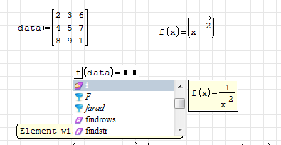

#40 Posted: 3/30/2016 12:13:03 PM
Ruben Sidranski
Ruben Sidranski
17 likes in 465 posts.
The problem is that "vectorize" is not passed through with the function definition
You will notice that the vectorization "arrow" is missing in the definition of f
