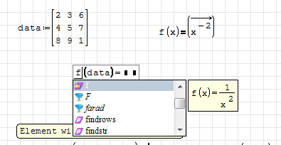

Hello Andrey!
recently i found out about an issue with the Viewer, might it be possible to fix the update proces while using plugins like the comboboxList?
Please see the example pictures and you see the posibilities of the second list don't change
with the selection made in the first one, wich is non of a problem using
the file with SMath Studio... only with the Viewer it fails.
Thanks a lot for concerning!
I'd appreciate your help very much!

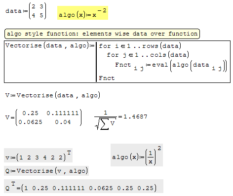

Sergio,
Your example that works elements wise, check for other issue:
vectorise as you did ... SQRT( ... result at the bottom of
the attached work sheet in light red.
Utilities Matrix Vectorise EXPRESS.sm (56,49 КиБ) скачан 1405 раз(а).
... read more as well.

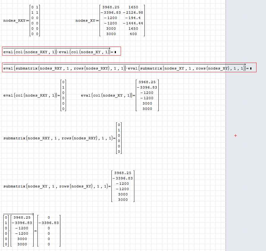

sergio 09.03.2016 06:05:00
#23 Опубликовано: 09.03.2016 03:14:21
What do you think Andrey to put then invert() function as well in the exception?
Function transpose() will get into the operator but invert() will not. Therefore, there is quite a difference between rising a matrix to a negative power inside vectorize() and having invert() inside vectorize(). For example, we have abs() and det() but inside vectorize() there is visually no difference.
I also hope this will not open some other issues regarding the vectorize() function.

#24 Опубликовано: 09.03.2016 03:35:36
Quite right Radovan,
That will require a "task force" checking wrt Mathcad.
The collection of vectorise is huge ! and would be
partial wrt functions not implemented in Smath. In the
mean time, the options in the previously attached
work sheets are VISIBLE. The risk of conflict between
"conventions" and "inventions" is silent/present.
Remember the Smath missing col operator <,> ... +++

Jean,
thanks a lot for sharing ...your approach with the algo technique of passing a function ..to a function is very interesting .
It is something I had never thought that was possible to do, it is very elegant and concise.
Thanks again and best regards
Franco

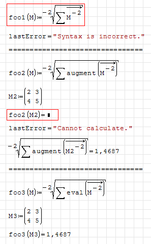

I'm not sure if this had been asked:
Currently, it's impossible to create a function like
f(M)=sum(M)
because sum takes only matrices, and M here is unknown type.
Using, say, augment(), which return type is known to be a matrix, I can do this:
f(M)=sum(augment(M))
I cannot use vectorize(), because its return type may be scalar like in vectorize(1), or system.
Though I can use it with eval().
The question is, is it possible to make vectorize always return matrix? When argument is a operation on system, for example, the result type differs from input. Having this could allow for such constructs without evals.
Or maybe allow sum to accept any type of input, making it return input itself if it's scalar/system/string?

It is unfortunate that eval() prevents vectorize() from evaluating its arguments one-by-one.
For example:
f(x):=(1/x)^2
vectorize(mat(1,2,3,4,2,2))=mat(1,0.25,0.1111,0.0625,2,2)
f(x):eval((1/x)^2)
vectorize(mat(1,2,3,4,2,2))=mat(5.5,-2.5,-3.75,1.75,2,2)
If the expression of vectorize is optimized before by-element evaluation, then it's impossible to use, say, linterp() in such functions, and eval doesn't help.

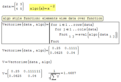

#35 Опубликовано: 22.03.2016 08:55:01
Vectorise is specific to Mathcad, then new to Smath.
A risky new bugger that does not speak, won't match
Mathcad either ... and almost impossible to exhaust.
We can expect more and more of that in the Forum.

The problem is that "vectorize" is not passed through with the function definition
You will notice that the vectorization "arrow" is missing in the definition of f
