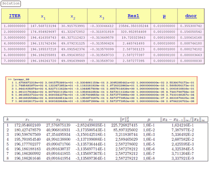

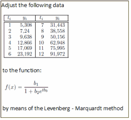

SMath Forum SMath Studio Samples Levenberg Marquardt Method 1 Pages (2 items) Levenberg Marquardt Method - A simple sample of the application of the Levenberg Marquardt method - Messages Go to last post #1 Posted: 7/17/2018 9:17:58 PM CBG 78 likes in 312 posts. Group: User Levenberg_Marquardt_Code_CBG.sm (137.38 KiB) downloaded 1270 time(s).Best RegardsCarlos #2 Posted: 7/18/2018 12:03:02 AM Jean Giraud 983 likes in 6,866 posts. Group: User Thanks Carlos,For meditation. Hover the pointer on φ(x,β) to see Conjugate Gradient.The model is puzzling, if you want so: can try expGrow as an exercise.JeanGenfit Minimize MODEL Test.sm (39.95 KiB) downloaded 1198 time(s). 1 Pages (2 items) New Posts No New Posts
