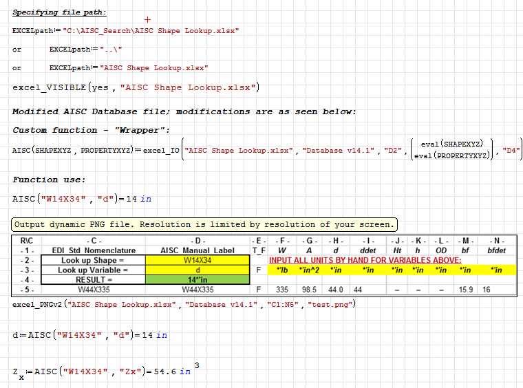

Not sure if I am grasping the root of the issue, but you can fairly easily write a wrapper as a smath user defined function using excel_IO. One would think that this way you can write a wrapper for any custom .dll for EXCEL.
All I have done was creating a simple Index(Array,Match(),Match()) lookup in EXCEL (with proper implementation of SMath units), and used excel_IO to work with it.
Seems to work very fast.
As always - please test for bugs and use at your own risk.
P.S.: Update excel plugin for proper handling of cell error values

ioan, i am working on getting the files downloaded and figured out. but reading the comments, i think that the root of the issue is getting missed.
the database and spreadsheet by design is supposed to have blank vertical regions because not all shapes have all the same properties. we don't want to process it further. we really done want to decompose it and condense it. that will lead to errors and confusion.
the database and spreadsheet get regularly updated. this file in fact has been in use for 15+ years. when updates to shapes occur, these files get republished. that way, there is some predictability in accuracy in information, and repeatably.
ryan- look again at the example that Alex.M put up. I think I emailed you another example sheet when i got it figured out. all you do is program the shape and property you are looking for and it talks to excel and it spits it back to you. you don't have to worry about lookups and column numbers.
it pains me to say so, but i think that you are doing way more work than is needed in your example calc. and there is the issue of verification. by burying the calcs in hidden sections and then recalling it is hard to check and verify. are you really saving much time doing this sort of calc in SMath vs something like RAM Sbeam? for one beam design, its hard to beat.
here are some examples of how the calcs are done in excel. first picture has 2 halves. left half is what i print. right half if i need to put it in the calcs as a reminder or for review/permit. individual cells in gray on the left are user input.
the second picture, the stuff in gray is what is behind the image of the connection on the right side, and is some of the work in the background. and yes, i am little guilty of doing the same thing i pointed out to ryan as bad form, but the calc topic and result is more explicit.
I think the best solution right now is what Alex provided us so far- giving us a pseudo-wrapper to push/pull from excel. we can simply define the shape and the property we need and move on with our calcs.

Hello Ioan, xlsx files in my plugin are opened and closed on the fly, what kind of problem have you experienced?
#34 Posted: 1/6/2016 1:47:15 PM
Alexander O. Melnik
Alexander O. Melnik
127 likes in 498 posts.
Hi Ioan,
The reason why excel_IO plugin connects to an already open file is because it works with EXCEL api and can connect to running instance of EXCEL. It does not quit the EXCEL process; instead it connects to it, makes it invisible, and does the calcs. Once SMath workbook is closed the plugin will make the EXCEL window visible again.
I believe Davide's plugin reads/writes xlsx files directly (unless the file is locked by EXCEL or any other process) - this is very useful for folks who either do not have EXCEL installed, or do not want SMath to rely on any dependecies (both are very valid reasons / desires).
Davide Carpi 1/6/2016 7:14:00 PM, ioan92 1/6/2016 1:52:00 PM

Wow, lots of action while I was away. First, thanks for everyone's contribution. I think we have already achieved a lot. I will try to summarize what I think our different objectives are.
The main goal as mentioned by Dennis was to incorporate (by some sort or hard coding in smath) the ability to select a steel shape and instantly have access to its section properties. Essentially all the user has to do is select a shape from a drop down and bang all properties are now defined or could be easily retrieved.
Alex formulated a simple function (aka wrapper) in order to input a shape's name and retrieve whichever property you would like. My two (minor) issues with this is that 1.) I generally need all the properties of the shape (mostly because I will incorporate torsion/warping into my calculation) so it was a bit tedious/ugly to have to call the function multiple times. But I did do this and it worked (thanks Alex!). 2.) So I took it one step further to hide it in a function (uh-oh, nobody likes this). I apologize as I think this has muddied the waters. I do appreciate the transparency of SMath calcs (as I think we all do), but I also like to be able to repeat a calculation on a single .sm page. Therefore the need for the function.
Ioan has created a program that succeeds in the task as well, I just need to try and fully understand it.
Alex also seems to have a work around for my function request, thank you!
So we seem to have solutions on the table, now I just need to figure out what's fastest/simplest to implement. And yet we won't be happy until we can select a shape from a drop down and have all the section properties ready to be defined into variables without having to fiddle with the excel sheet at all. <-- That sounds like the life of a software engineer :d
Again thanks to All!
