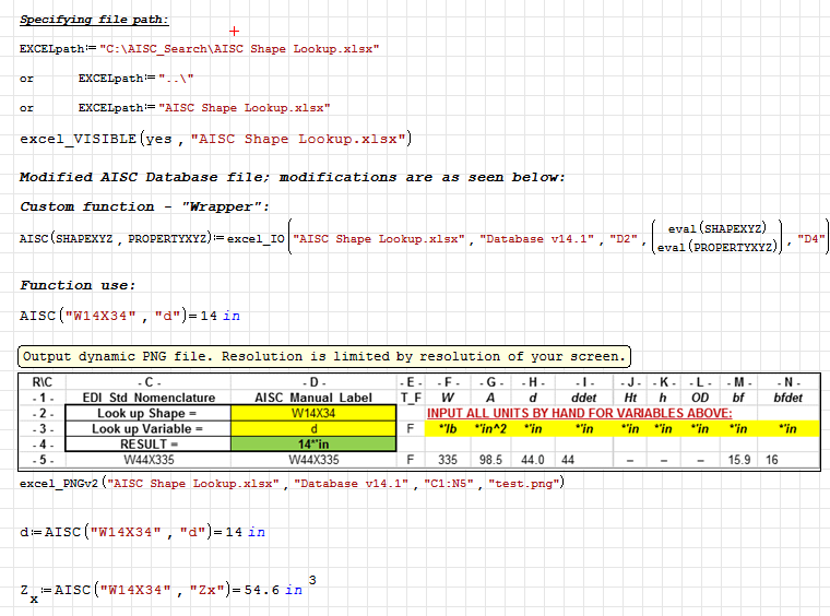

Not sure if I am grasping the root of the issue, but you can fairly easily write a wrapper as a smath user defined function using excel_IO. One would think that this way you can write a wrapper for any custom .dll for EXCEL.
All I have done was creating a simple Index(Array,Match(),Match()) lookup in EXCEL (with proper implementation of SMath units), and used excel_IO to work with it.
Seems to work very fast.
As always - please test for bugs and use at your own risk.
P.S.: Update excel plugin for proper handling of cell error values
AISC Shape Lookup.xlsx (3,27 МиБ) скачан 1859 раз(а).
Steel Properties Look-up.sm (20,36 КиБ) скачан 1342 раз(а).

Steel - Property Lookup Test.sm (29,71 КиБ) скачан 1224 раз(а).
AISC Shape Lookup.xlsx (2,91 МиБ) скачан 936 раз(а).
Here is what I'm working towards:
Steel - Function - WF Design.sm (84,79 КиБ) скачан 1282 раз(а).

While I am uncertain what would the the best approach to this problem, I am dedicated to make my excel plugin work as intended.
To RFreund and SinneD:
It seems that when my plugin is called inside a programmed function it has a difficult time identifying the working directory on its own. See a work around attached (define absolute path by concatting workingdir() and xlsx filename). I might try to pinpoint the bug if I have time - use the work around for the time being.
To ioan92:
I would much appreciate if you could let me know why the plugin does not work for you - again I am dedicated to fixing it if necessary. A good starting point is to delete and redownload the plugin from extension manager - it is still work in progress.

First of all I would not want to take credit for something I have not done - it was RFeund who created the majority of the SMath workbook you were looking at. I just helped him to make it work as he intended. So I will leave it up to him to incorporate first of your two very relevant comments.
Small note though - the latest version of the plugin (0.2.0.28218) should import values with units from excel. Those units can be converted to inches as per usual SMath operation:
I will want to learn how to use combobox plugin - I beleive the worksheet you attached earlier is a good guide :-)

The reason why excel_IO plugin connects to an already open file is because it works with EXCEL api and can connect to running instance of EXCEL. It does not quit the EXCEL process; instead it connects to it, makes it invisible, and does the calcs. Once SMath workbook is closed the plugin will make the EXCEL window visible again.
I believe Davide's plugin reads/writes xlsx files directly (unless the file is locked by EXCEL or any other process) - this is very useful for folks who either do not have EXCEL installed, or do not want SMath to rely on any dependecies (both are very valid reasons / desires).

i was trying to point out that we have gone very far from the original question posed by ryan and i (is there any way to directly implement a search dll that gets called by an Excel VBA macro into SMAth directly). we are now solving a different problem, one that we have intentionally created by trying to work around a different one.
i think that the discussion has prompted good development and valuable discussion. I am grateful for Alex's comments because it has give me new tools with which to use within both Excel and SMath.
EDIT: regarding my admiration's- you misjudge me. I think Excel is the wrong tool for many applications, propagated by fools. The AISC database is a pain the behind, but it's the accepted consensus method. I was baptized in the river of Mathematica by none other than Theo Gray himself. Then I was forced to drink from the fountain of MathCAD. I choose to use SMath.
Excel- I really don't like Excel, but many engineers in the US (and any other math based profession) had it crammed down our throats as a tool to use because it came with PC's throughout the 90's and there are so many legacy calculations we have to maintain. As you can see from Ian's comments, we are not the only ones dependent on Excel for this sort of work. Our database gets updated everytime the code comes out. And there is the historic data one too that we have not even looked at. The format of the files are consistent between revisions.
Excel- excel seems to remain open, hidden or not. Alex described it exactly above. I often already have Excel open calculating other things already that I use to manually input into SMAth worksheet. I noticed that if SMath takes the focus from Excel doing work called up by SMath, then the other open spreadsheets get flaky really quick.
I have taken to:
-explicitly defined the directory and file that within SMath
-force Excel to be visible.
This is what I have been putting in my worksheet to be explicit for definitions. I am still trying to work through Davide's example.
