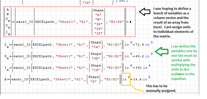

In Excel, we use it to lookup information to use in calculations like this-
I do not know enough about programming to figure this out on my own just yet. I have attached the files with dll, docs and dependencies below.
Is this something that we can use in smath? Can we call it natively?

So this is proving to be more challenging than I imagined.
I think I can do what I want with some judicious trimming and logic. But I need a little help...
1. Symbolic optimization for importing data from spreadsheets: Does this matter if some of the entries in the cells are text entries?
2. Finding the right row is a challenge. the vlookup function would be what I would use in Excel to find the right row. Once I can get to the right row, I can extract the column that I need.
My challenge is getting to the right row in an efficient manner. Once I can get to the row, I can make the definitions that I need.
Thing is how do we 'find' the row efficiently?
Dennis

Can you think of a way to do column vectors with ordinates and units? For example I want to define the following variables as a column vector in SMath, then pass to Excel, do some work then bring the resulting values back to SMAth to do more work. It would be advantageous to be able to have units built in.
For example the 6 row vector defining variables for shape size, area, weight, and 3 physical properties.
Shape
A
W
Sx
Zx
Ix
Pass that 1x6 array to Excel.
Excel then uses the first argument to find values for A, W, Sx, Zx, and Ix.
Return 1x5 that to SMath. As a single operation it works.
But when I try to use it to define variables, then it gives me a syntax error.
Shape
A
W
Sx
Zx
Ix
Файл не найден.Файл не найден.Файл не найден.

I though that we could define a group of variables as a column vector. Now that I try it I see that it does not work...
That is the last bit of the worksheet that I posted.

Little late with my reply, but here how you can use PNG in your calcs if you choose to (see attached).
Also you can include the units if they are defined properly in excel file (update plugin). See attached.
AISC Shape Lookup.zip (1,9 МиБ) скачан 559 раз(а).
