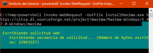

Hi Viacheslav. That could be an option, but I'm thinking in concise instructions using very basic system tools. For example, this is for download the last 32 bit maxima installation:
1. Open a windows command windows as administrator.
2. Go to some temporary directory
3. Execute this line
powershell Invoke-WebRequest -OutFile InstallMaxima.exe https://sitsa.dl.sourceforge.net/project/maxima/Maxima-Windows/5.47.0-Windows/maxima-5.47.0-win32.exe
4. Then silent install maxima in AppData\Roaming\SMath\extensions\plugins\MaximaDistribution with this
... etc

This code can download windows 32 bits current version, silent install and open Maxima.xml configuration file. Just copy and paste it into a cmd command window.
 rem @Echo OFF
C:
cd %AppData%\SMath\extensions\plugins\44011c1e-5d0d-4533-8e68-e32b5badce41
InstallMaxima.exe /S /D=%AppData%\SMath\extensions\plugins\44011c1e-5d0d-4533-8e68-e32b5badce41\MaximaDistribution
@Echo OFF
echo *********************************************
echo .
echo  Modify <PathToMaxima.bat> with this value:
echo .
echo  %AppData%\SMath\extensions\plugins\44011c1e-5d0d-4533-8e68-e32b5badce41\MaximaDistribution\bin\maxima.bat
echo .
notepad maxima.xml
rem Exit /B 0
But the file maxima.xml could be update from the command line too, and with that the automation of the maxima installation process is complete.
