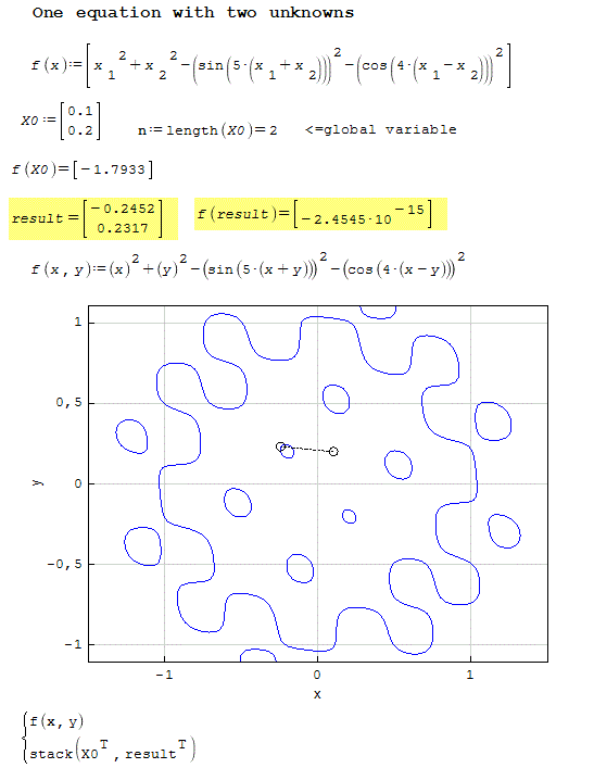

Fortunately, I was wrong. We could use it with different number of equations and unknowns.
I just use the Ber7 example and change it with n as a global variable. No need for zeros as non-existing functions.
Primer%20Uni-mod.sm (13.3 KiB) downloaded 1610 time(s).

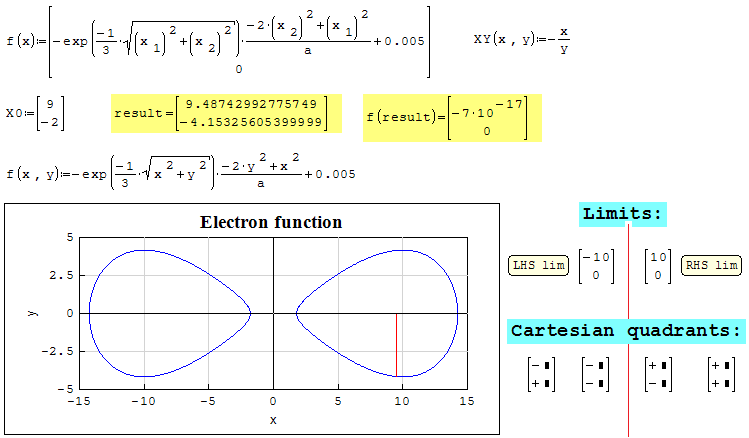

But for some reason simple Newton-Raphson with variable step usually
works better than al_nleqsolve.
#25 Posted: 7/18/2018 3:19:47 PM
Can you demonstrate for this application ?
Solve al_nleqsolve-Electron.sm (18.41 KiB) downloaded 1527 time(s).

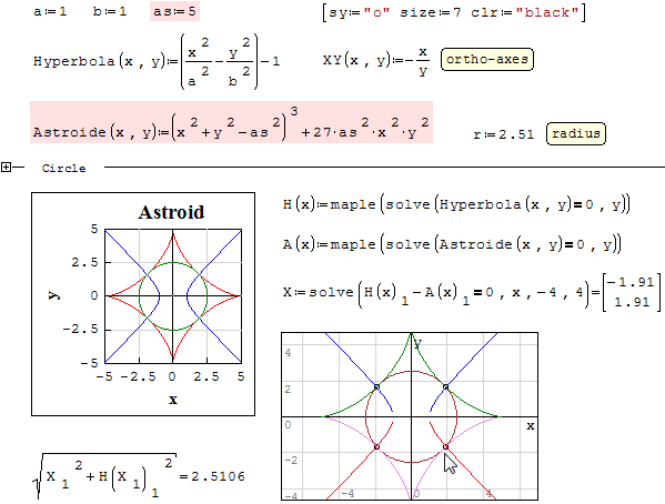

The intersection points of two curves
Primer1b.sm (33.88 KiB) downloaded 1545 time(s).
Primer1b.pdf (212.69 KiB) downloaded 868 time(s).

#32 Posted: 8/22/2018 11:39:31 AM
Fridel Selitsky
Fridel Selitsky
520 likes in 451 posts.
Fixed. Now you can find all the intersection points.
Primer2.sm (36.58 KiB) downloaded 1568 time(s).
Primer2.pdf (215.28 KiB) downloaded 883 time(s).

... thanks Ber7
Contour SOLVE AstroidHyperbola.sm (20.85 KiB) downloaded 1571 time(s).

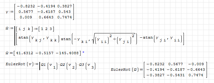

Hi. The same, but without plugins.
SphereSMath.sm (75.21 KiB) downloaded 1490 time(s).
PD: Do you know the angles for your rotation matrix gamma? I get this, but can't put the matrix elements in the correct order nor sign:
Actually, as I know, the minus in the last atan is a mistake, but at least give the same absolute values.
Fridel Selitsky 10/8/2018 3:35:00 AM, NDTM Amarasekera 10/8/2018 4:19:00 AM
Hi, Alvaro.
Unfortunately, I have never done reverse transformations (gamma-omega).
Your error may be caused by the use of the left coordinate system in Smath- graphs.
I selected the angles for the axial matrices empirically in order to get a good perspective ,using the gamma matrix.perspective.

#39 Posted: 10/10/2018 12:40:38 AM
Mathcad solves the Euler angles from a given γ [gamma matrix].
Smath does not immediately, it complains: Try to use a more specific algorithm.
There are 24 [4!] possible ways to define a 3D system [Mathematica].
The most common is Euler though Mathcad Mathcad ≠ Mathematica.
For common use to define some pleasant views, especially in Smath:
1. Euler [ 3 trig angles]
2. Parametric [X,Y,Z,t] very easy to manage.
3. Quaternion only two coefficients that Quaternion solves for the 3D γ matrix
Rotate Horn.sm (15.07 KiB) downloaded 1523 time(s).
Solve Euler Fails.sm (22.54 KiB) downloaded 1580 time(s).
Rotate Breather [Euler].sm (37.2 KiB) downloaded 1338 time(s).
Rotate_0 Euler, xyz(t), Quaternion.sm (275.27 KiB) downloaded 1568 time(s).

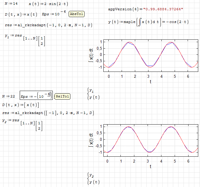

#40 Posted: 12/12/2018 12:57:19 PM
1,555 likes in 1,867 posts.
Updated.
Changes for al_rkckadapt():
- zero point issue fixed;
- added support for the simple D(t,x) definition.
