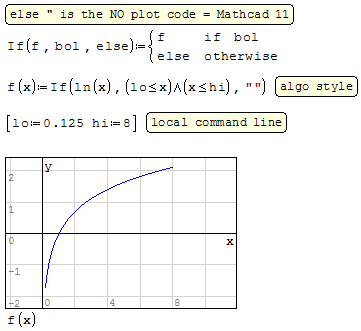

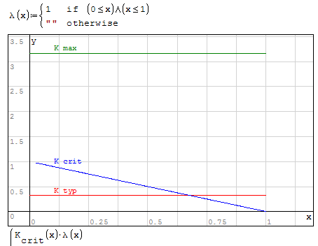

#5 Posted: 3/21/2022 8:20:41 PM
Bolean bug(s) are user bug.
Many projects will accommodate either style if/else ... if/otherwise
A long suite of conditions is horror if/else.
Doctor your plot 1 as proposed, press F9
Integrate Discontinuous_1.sm (24.57 KiB) downloaded 1533 time(s).
Integrate Discontinuous.sm (36.51 KiB) downloaded 1571 time(s).
Integrate Discontinuous_2.sm (132.47 KiB) downloaded 1566 time(s).
