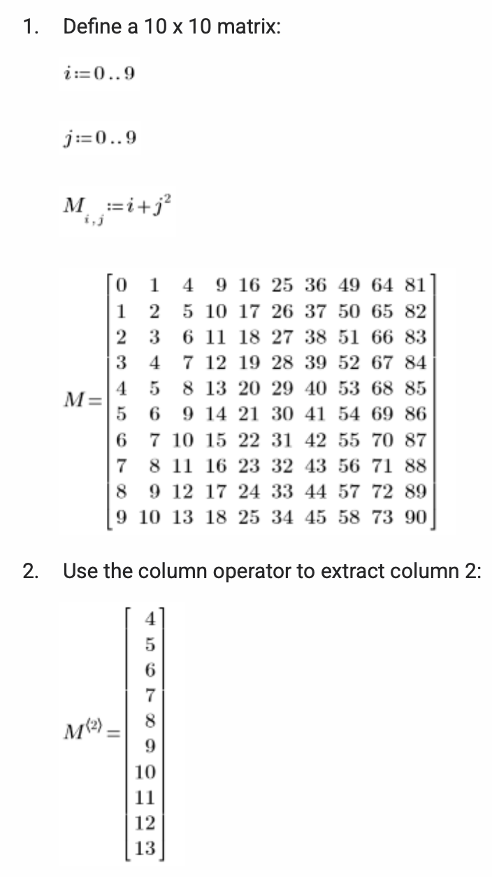

Hi everyone, is there a way to implement mathcad column index operator in smath?
Edited 8/3/2025 8:59:35 AM

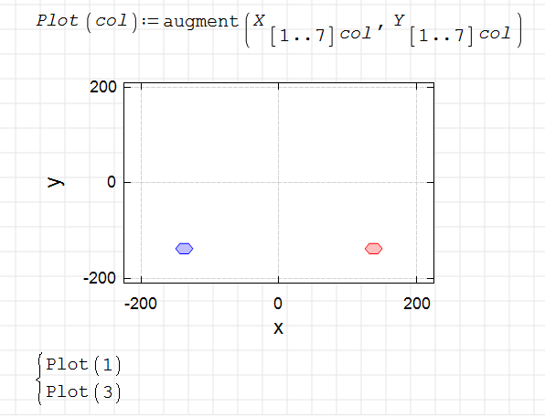

You can use ranges in indexes.
Some examples are built into the component itself. They are needed for self-training of the user.
Edited 8/3/2025 9:37:35 AM
