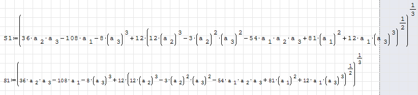

#4 Posted: 3/18/2016 10:17:13 PM
I would imagine Andrey could implement some sort of a wrap setting.
It is all text after all.
On the other hand, if your equation does not fit in a page, are we trying to do too much
in one equation? I did run into this issue myself and I ended up separating things
Easy in Mathcad, but might turn a blody mess.
Much easier to split in components in Smath and
lot more elegant.

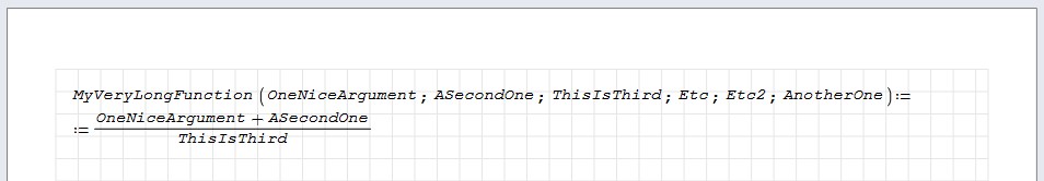

#13 Posted: 4/13/2021 12:37:45 PM
MBe
MBe
2 likes in 21 posts.
Hello everybody,
sometimes the definition of a function requires multiple arguments and if you want them to be "self-explaining" (at least to a certain level) you have to use meaningful names for those. All these conditions might bring to a long line before you can type ":" and start with a definition line.
At this point, the space on the paper for statements along the function definition might become a bit tight and the definition itself might be not printable(anything falling out of paper limit will be cutout in printing).
Any chance to have a split at ":=" in order to have the function definition beginning at the left margin of paper?
Something like:
MyVeryLongFunction(OneNiceArgument, ASecondOne, ThisIsThird, Etc, Etc2, AnotherOne):=
|A:= OneNiceArgument + Etc2
|B:= ThisIsThird * AnotherOne
|Calculation:= .....
|ToBeContinued...
Thanks for any help on this subject
Marco
#14 Posted: 4/13/2021 4:21:43 PM
2,343 likes in 4,043 posts.
Hello Marco.
Something like:
|Calculation:= .....
|ToBeContinued...
Yes, it is possible. After you have finished composing formula for definition just put the cursor before := and press Ctrl+Enter. This will produce something like
MBe 4/14/2021 5:17:00 AM
