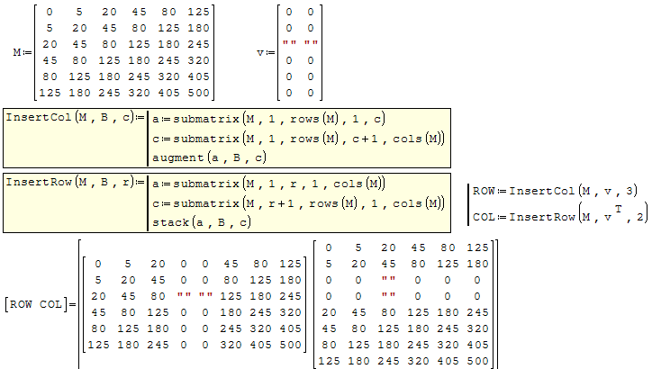

Adding a row or column in Mathcad, mid Matrix, was simple. In SMath, I cannot copy portions of the matrix to move the information (all or nothing) as I've tri. Am I missing anything?

Easy/simple ... it's ADD not INSERT

Simply => submatrix !
#6 Posted: 4/12/2018 8:37:35 PM
WroteAdding a row or column in Mathcad, mid Matrix, was simple.
In SMath, I cannot copy portions of the matrix to move the information (all or nothing) ...
simply submatrix !

#9 Posted: 4/16/2018 5:24:55 PM
Jean,
Sometimes your convoluted solutions really do inspire ... when I understand them
Here is a work around that works for me. I did NOT try it as an insert to column or row index 1 as I assume these exist. If those are needed, I guess we use augment. At the end of a matrix, we can just pull the handle. RS_Insert cols_rows to Matrices.smz (6.87 KiB) downloaded 1626 time(s).
Thank you
Thank you
#10 Posted: 4/16/2018 9:08:50 PM
Pad(M,nc,nr) ... padding a matrix has the meaning centered [nc,nr] insertion,
reserved for Fourier 'ifft'... why did you remove it.
For common work, rater use InsertCol/InsertRow.
RS_Insert cols_rows to Matrices(1).sm (47.58 KiB) downloaded 1670 time(s).
