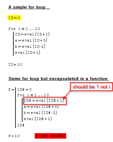

This example should be self explanatory. I expected same output in both cases. Is this a feature or a bug? Caused disaster in my formula logic.
Thanks!

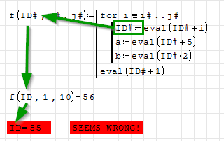

You are using pass-by-reference, that assign a value to an input argument when it is the target of an assignment inside the procedure (see here f.e.)
2016-11-14 01_50_19-Feature or a bug_ Cannot force numeric evaluation within a function.png
the last assignment is missing; to assign the same value both to the result and to the input variable you have to define ID#:eval(ID#+1) even after the loop.
2016-11-14 01_53_10-2016-11-14 01_52_11-SMath Studio - [FunctionBug.sm_].png - Visualizzatore foto d.png

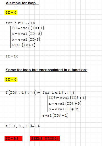

Davide, pass by reference assignment is intentional. What i do not understand is why
The result is 56 and not 10 - I used eval() to assign a static value to ID#, or so I thought, but ID# was assigned a dynamic ID# = ID# + 1, which was not the intent.

Hey, in first block, you incremented ID by 1 in loop; in second you do it by self-incrementing i!

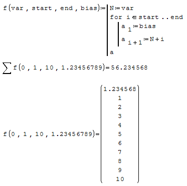

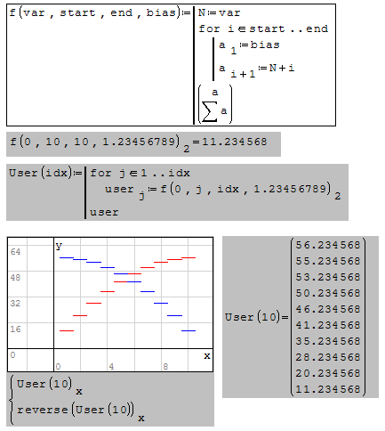

... more conveniently and generalised.
Maths SUM.sm (10.68 KiB) downloaded 1047 time(s).
Ah! Now I see it.
This is the cause

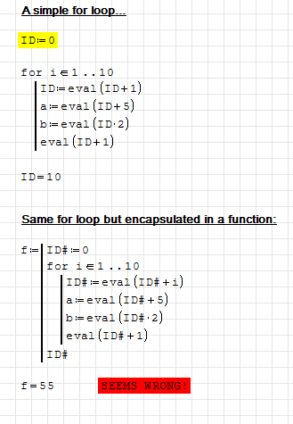

Thank you all; so far I understood that something should be clear to me by now, but its not. What can I do to encapsulate a seemingly simple for() loop in a function that produces same result (10)?
FunctionBug1.sm (6.67 KiB) downloaded 1031 time(s).

I just hope that you did not see "1" - one instead if "i" in the loop.
Was that the problem or something else?
#10 Posted: 11/14/2016 6:06:10 PM
Alexander O. Melnik
Alexander O. Melnik
127 likes in 498 posts.
Hello Alex M.
I was blind as a mole. Thanks
