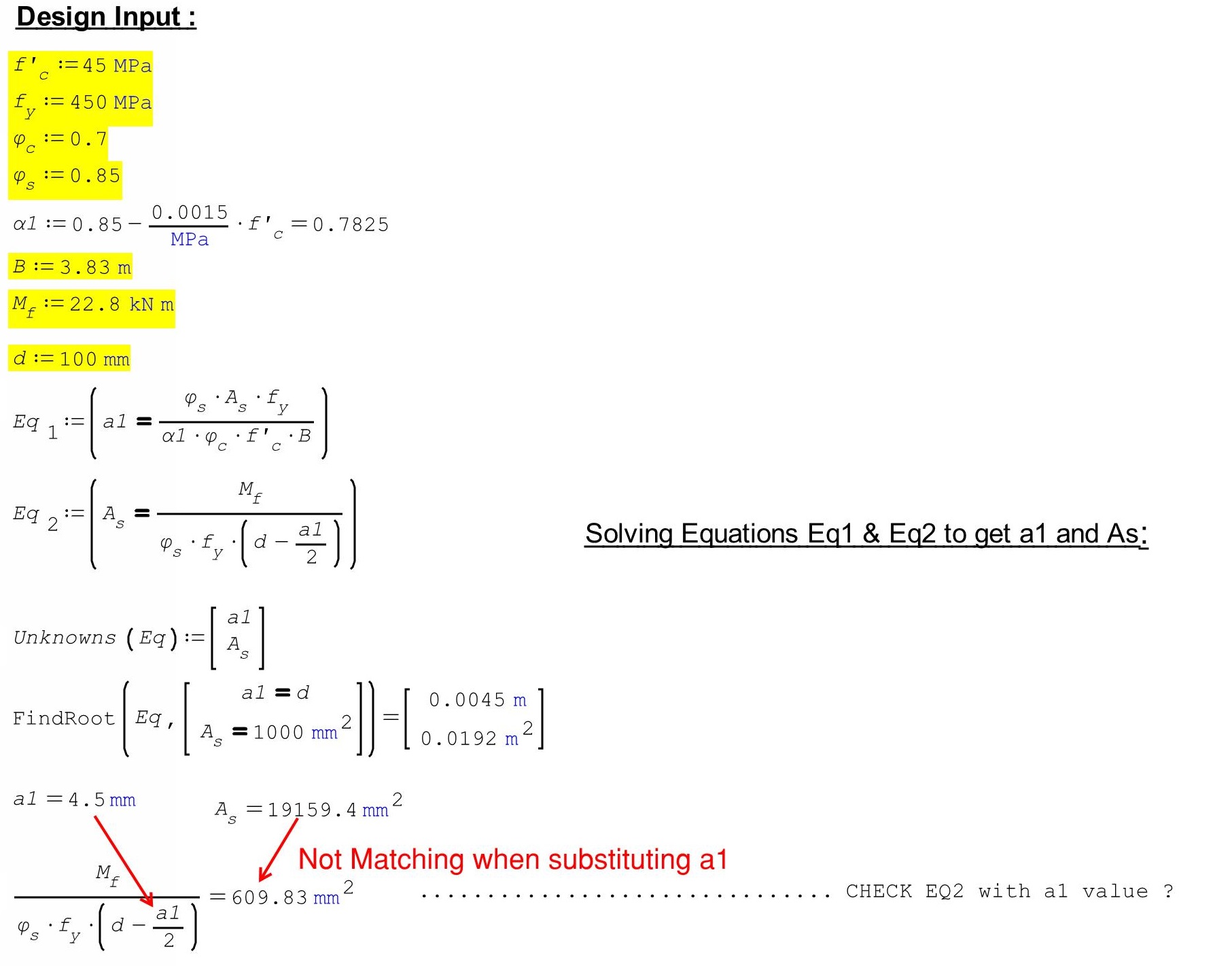

I was trying to solve 2 equations and getting the root using FindRoot with weird results, that when substituting with the SMath results the equations don't yield to the same results.
I know using units seem to create problems, but it sometimes works and I need to solve this somehow.
any suggestion?
Test.sm (287.52 KiB) downloaded 1132 time(s).

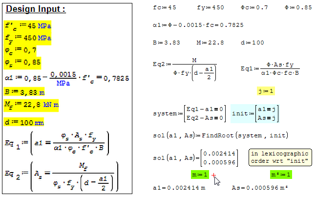

#3 Posted: 5/4/2019 7:01:20 AM
Somehow it works better reversing the unknowns... dunno why...
Also since you are working with units you have to pay attention at the required precision. The one shown in the function description is about the base units, m for the length and m^2 for the area.
Test - r0.sm (277.65 KiB) downloaded 1147 time(s).

Jean, as a structural engineer I deal a lot with units and creating a sheet without units is not professional and typically creates errors from users which we try to avoid. I read on other forums that the function works well without units (same as your sheet) so I prefer to find a way that works with units.
Davide, I am worried because this error should not occur.
I mean do I need to check every time I change my input that my output is correct?! and try to flip the variables to make it work? I tried your code in another old sheet and it did not work, I had to stick with the order a1=d first then the Area to make it work properly!!
Also, what happens if there are two positive real solutions, which one will be shown by SMath?
Thanks a lot for your help!!

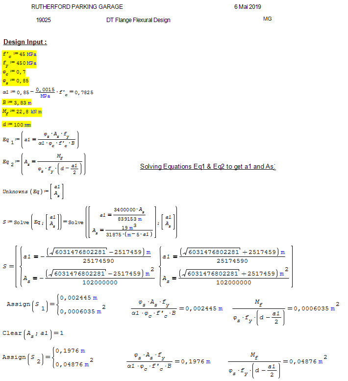

If using the Maxima plugin is an option for you, then the solution is straightforward.
- Units are no problem for the plugin (they are converted into symbolic variables, Maxima itself isn't unit-aware).
- Multiple solutions are returned by Solve as a row vector of solutions (with each being a list of equations). You can pick the solution by
index and apply it using Assign().
I don't know how you can know in advance which solution to use. Perhaps the reasoning on which one to select can be cast into some test for index generation.
Best regards, Martin
test1_kr.sm (290.11 KiB) downloaded 1147 time(s).
